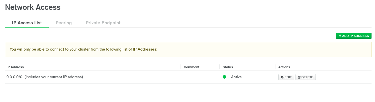

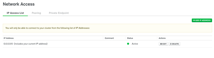

Yep @steevej .
It is set to “allow from anywhere” (0.0.0.0/0) but still the results are same.
