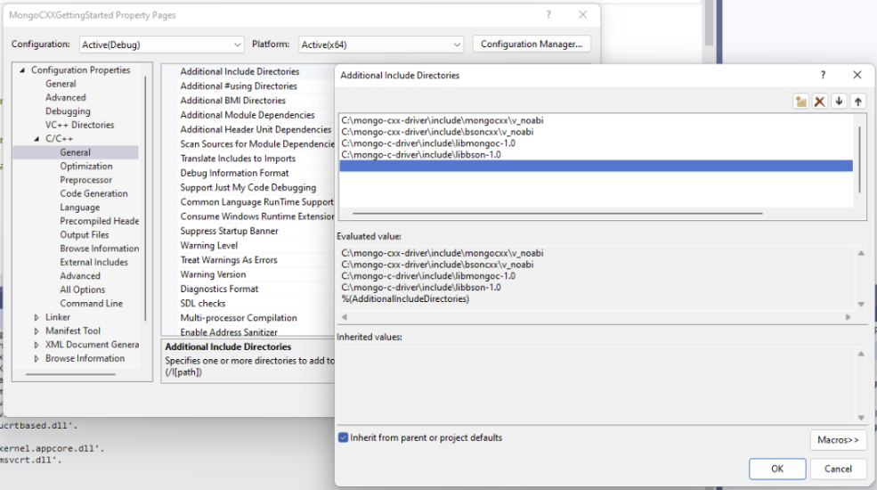

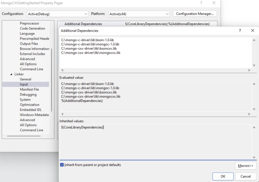

Thank you for a quick reply! I have followed the advanced tutorial you provided and installed the driver with vcpkg. I did every step except for “You can use the toolchain file…” as I don’t understand what it does or how to use it. I have created a console C++ application in Visual Studio 2022 and inserted the sample driver code from the C++ tutorial. But it cannot find the bsoncxx/mongocxx headers. I even included the paths to headers and libraries as shown in the advanced tutorial, but it still can’t find the files. What am I doing wrong?
If you execute vcpkg integrate install, that should automatically integrate the headers and libs with VS.
Are the headers/libs showing up in your Include paths?
If not, can you manually add them (see screenshot below to see where to add them) and double check the the path you are setting actually has the required headers/libs?

That did it! Thank you very much for your help! I’ll come back if I encounter any other issues.
