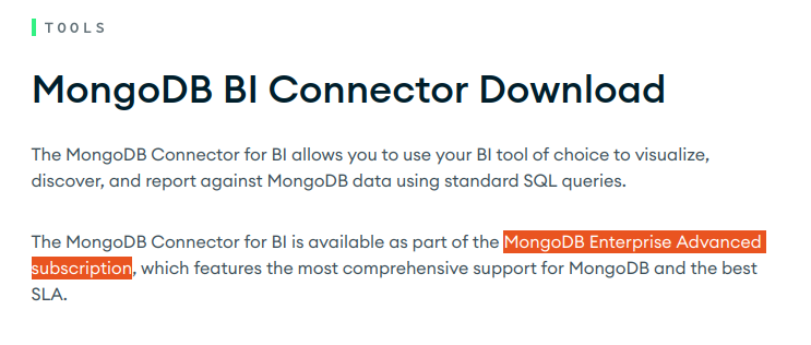

Still does not work, is the BI connector working for MongoDB 4.4.27 Community? Do I need to upgrade for the enterprise version?
Yes it an enterprise tool that required MongoDB Enterprise and a subscription agreement.
Some limited use is available without an subscription agreement.
