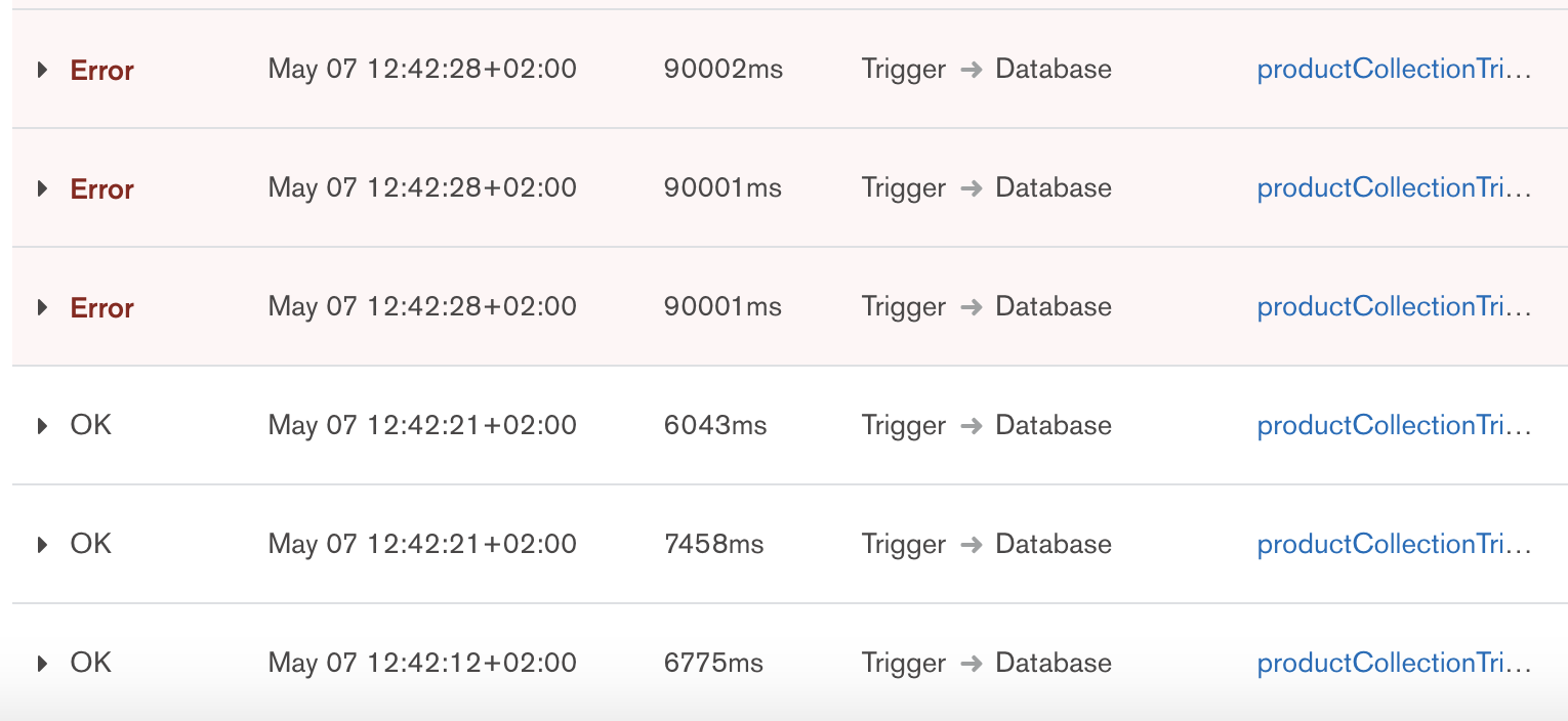

Trigger timing out (>90000ms) when function itself only takes 2000-4000s
We have an ordered Database trigger in realm on insert and replace to a collection that holds products. It runs a function, validating a product, to then send it to aws via kinesis.PutRecord. Everything works fine and on inserts of ~100 products the trigger takes max 1000ms per product.
Recently we added more functionality to the function that the trigger runs. This functionality searches in other collections for data connected to the product, in order to find if any data is missing.
After adding this functionality, the function itself takes max 4s (so 4000ms) to run per product (using the UI with the exact same data that the triggers receive).
However, when the trigger now runs the function it times out, taking longer than 90000ms.
What I find really strange, (except for the fact that the function should only take about 4000ms not 90000ms to run) is that the first 3 of 100 triggers seems to run as expected, until then all the remaining triggers time out
Any idea of what could cause this issue?
Worth mentioning is that it has worked sometimes. The exact same 100 products have been inserted and the triggers have been able to finish (with the same function) without reaching the time limit. The times have however, also in that case, escalated from ~6000ms to ~60000ms after the first few trigger runs.
Very thankful for any help you could provide.

Hi again,
I made a try run with the code that previously seemed to cause the time out, and without having made any changes to the code whatsoever from the previously failed runs, it now works as expected.
It does however make me feel quite unsure of realm, seeing as the same implementation can result in different outcomes…
