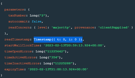

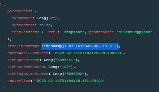

Now this is my operation with readConcern:local:
This is with readConcern:snapshot
This is with readConcern:majority
  1. Difference between snapshot and majority when using transactions is basically shard snapshot consistency with the former. (something like shardedSafeMajority)
I believe that’s it.
