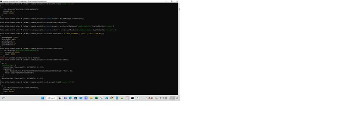

Please find screenshot .It ignore syntax error and commit transaction

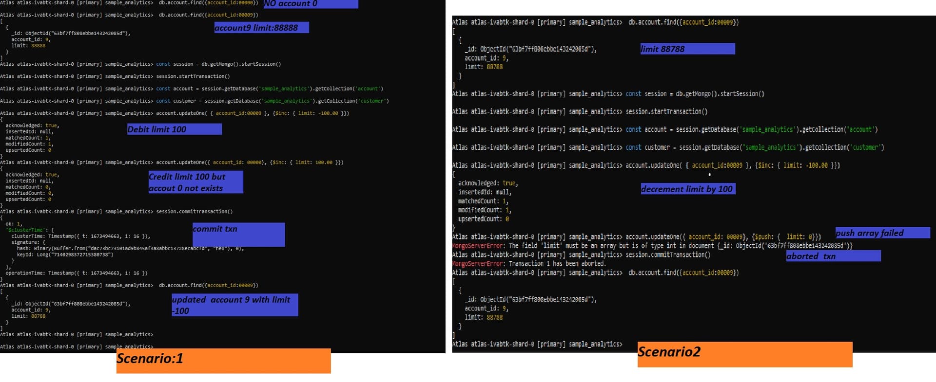

Hi Kelvin,
Sorry for bothering again then why did my scenario2 where I written same way aborted and rollbacked to original value
Ah I see where the confusion is :slight_smile:
I apologize to exacerbate the confused situation. I was using the example of a Node program (where {session} is required to make the CRUD operation work inside the transaction), and you’re using mongosh and grabbed the database from the Session object as per https://www.mongodb.com/docs/manual/reference/method/Session/#mongodb-method-Session
In scenario 1, I think everything behaved like they should:
  1. start transaction
  2. subtract 100 from account 9
  3. commit transaction
  4. account 9 has limit subtracted by 100 as it should
In scenario 2, there’s a MongoServerError:
  3. intentionally induce a MongoServerError
  4. transaction aborted
  5. account 9 was not subtracted
Am I following your thought so far correctly?
Basically scenario 2 showed that a MongoServerError would automatically abort a transaction. This is in contrast with your earlier example where you called insertyOne: it resulted in TypeError instead of MongoServerError, so the transaction didn’t auto abort.
Is this the information you’re looking for? Sorry again for the confusion.
Best regards
Kevin
So we can conclude that
Scenario 1: MongoDB Perspective its valid since Account :0 don’t exists. But taking a case financial matter were Debit=Credit will fail the business validation. Hence Application has to be intelligent enough to catch modiifiedCount:0 and do a rollback instead of commit.
MongoDB only rollback MongoServerError not TypeError .There also application need to be intellegent enough to do rollback instead of commit
In my opinion, MongoDB can only rollback what it can detect. The database is not aware of what else you are doing in your code.
A TypeError is a bug in your code.
Yes, your application should be catching all the errors that may happen in your code and ask for a rollback.
