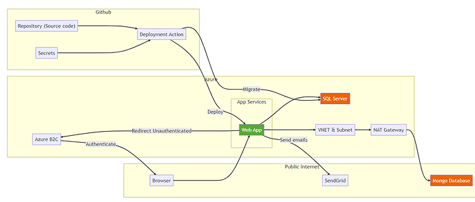

Hi, we are currently developing a Web Application using C# and Blazor (Dot net 8) with Mudblazor (6.11.1). We have a page which requests data from a MongoDb Server (Mongo Atlas ReplicaSet.) and displays it in our application. For this we are using the MongoDb Driver 2.22.0. The application consists of the following:
The application is hosted in Azure in the App Services Resource. The error prompts when the application tries to request the data after certain time of inactivity and in the console shows the following error:

It takes a while until the error is prompted in the web application and after the reloading it works fine (fast). It seems that when the server does not have activity and a request is made it gives the error but after that ping to the server it kind of becomes active and the requests made work fine.
We tried to replicate the error localy ( we are connected through a vpn) and it works fine. But when it is deployed in App Services, it is working intermittently alway prompting the error in the first attemp after inactivity.
