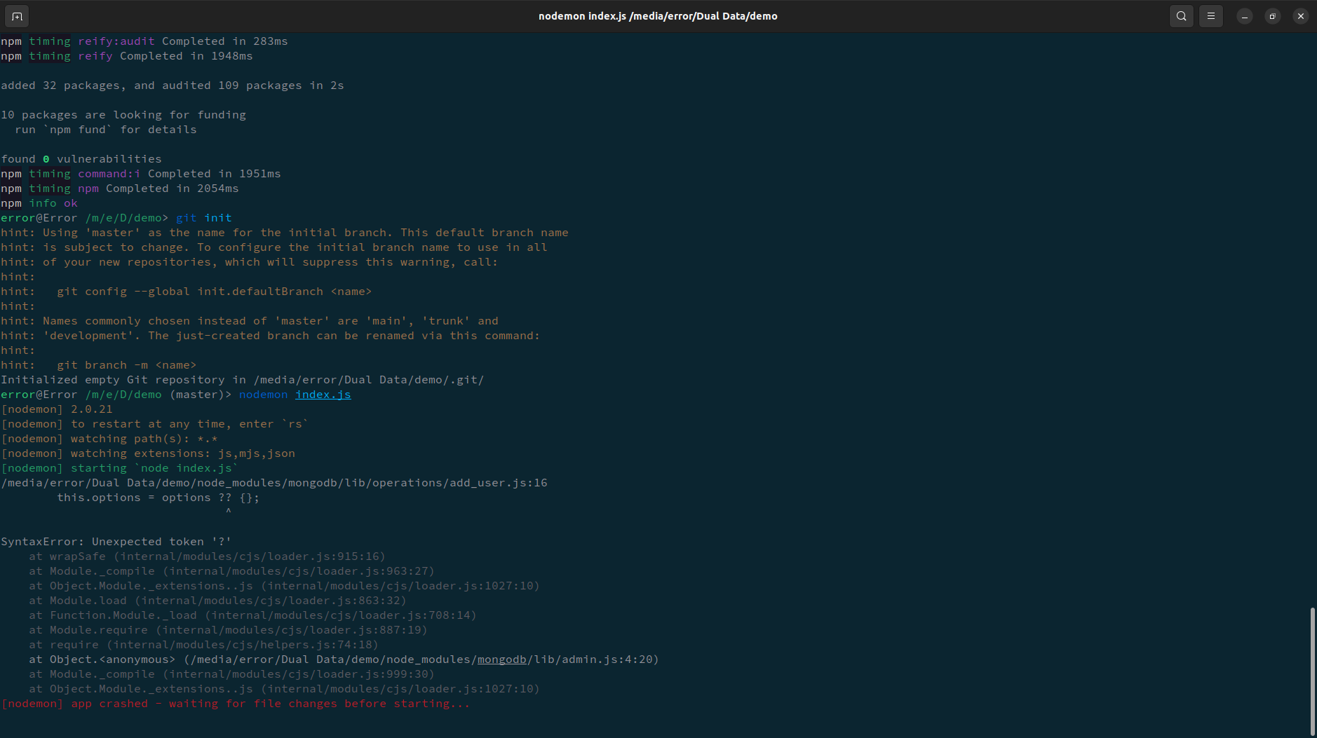

I run this backend on windows and kali linux worked perfectly but when I tried on ubuntu then it showed an error. could anybody help me?
Hello @Abu_Said_Shabib, Welcome to the MongoDB community forum,
I think you are using mongodb npm’s latest driver version 5, and there are Build and Dependency Changes, Just make sure the below thing,
Minimum supported Node version
The new minimum supported Node.js version is now 14.20.1

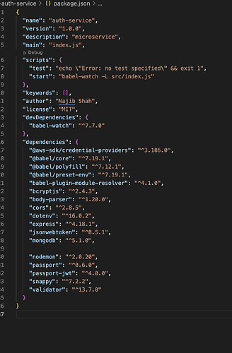

attaching SS of my package.json file.
I am using node version 19.8.0

As @turivishal mentioned the minimum supported Node.js version is now 14.20.1 for MongoDB Node.js Driver v5. So, please upgrade the node version to 14.20.1 or higher to resolve the issue.
However, you can refer to my response here where I’ve explained the cause of the this.options = options ?? {}; error.
I hope it helps!

Thank you so much.
my problem is resolve due to your solution.
