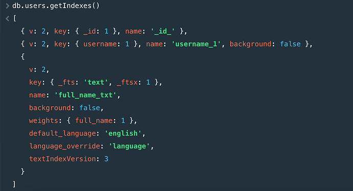

Hi @Prasad_Saya i am using MongoDB 5.0.9 Enterprise, Python 3.9.7 and pymongo 4.1.1
screenshot attached after running getindexes on users collection, right now i have removed index from username and index added on just full_name attribute just to get it start working but this issue is still unresolved
