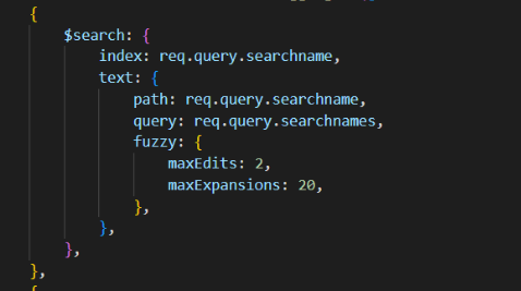

I am trying to query search index and text indexing in same query, as showing in picture below
But I am getting this error always
I tried changing the position of queries too, still error remains same.
Anyone help me and provide me a method how to implement both queries simultaneously.

Hi @Pavel_Duchovny , Thanks for replying.
We have a fuzzy search index created to search for a field named “CompanyName”, and simultaneously we also want a textSearch index, to search through multiple fields namely, “technology”, “business”, etc. I want to get AND results of both the queries using single Atlas Aggregation pipeline.

We don’t need to metion respective indexes in queries? as we have different indexes for different fields in a collection.
Like we mention here
