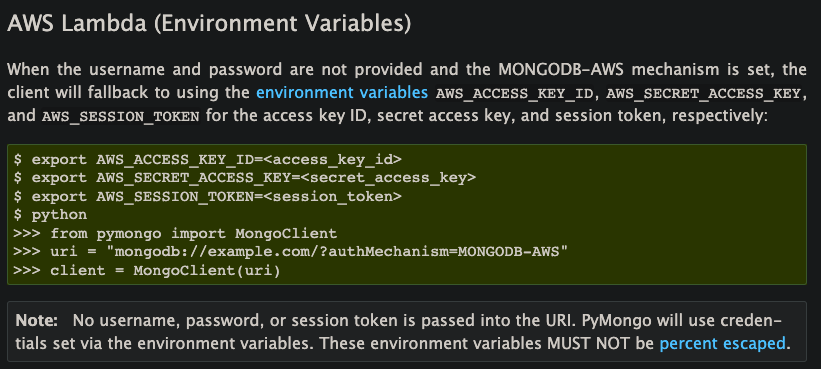

However this still times out… But i did read in the link you provided this :
And i notice 2 things compared to my URI string :
- I have not
authMechanism=MONGODB-AWS
- I should not be using the ENV VARS in the URI

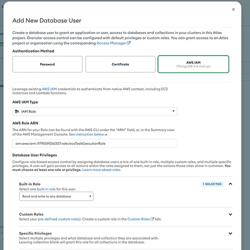

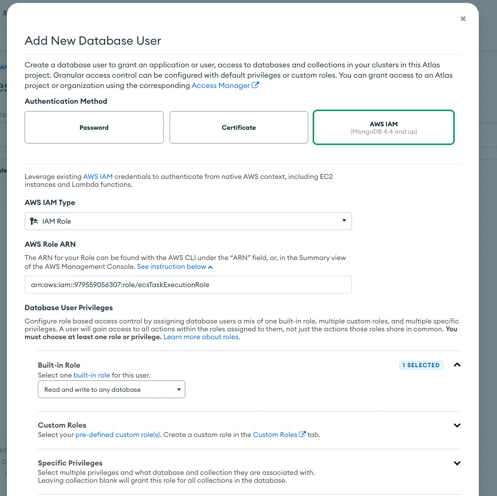

Make sure you have the proper ARN given under AWS IAM in Atlas as shown below:

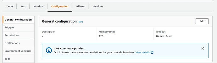

Secondly, could you try increasing the timeout for the lambda function? By default, the value is set to 3 seconds.
You can do so by going to the AWS Management Console and navigating to the below option:
Lambda function -> Configuration -> General configuration -> Edit Timeout

Also, i have setup to 10 seconds the time out of my lambda and this is still in time out unfortunately
