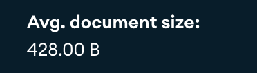

Average size of each document: 428B
Screenshot 2023-11-24 at 11.00.12 AM
