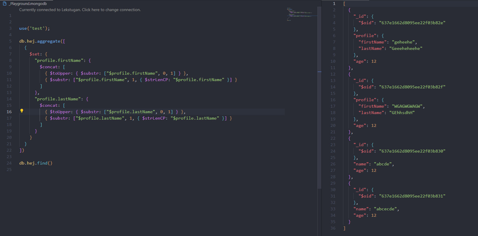

Hi @turivishal thank you! However it doesn’t seem to work? Nothing happens at all when i run the code?
As per your screenshot, you have added a find() query at the end and I think that replaces the aggregate() query result, can you make sure after removing that find() command?
I don’t know more about this editor so try to execute in MongoDB shell or MongoDB compass.
I am clearing the thing up, this aggregation query will format the result only not the actual document in the database, if you want to update permanently in the database then you have to use update commands with update with aggregation pipeline.
