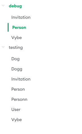

Almost. I was under the impression it should land under debug>Person not testing>Person.
Does it have to do with new. So if I change device sync database name it will keep the old one if there are collections there?

I actually recently filed a ticket to update the docs with more information on this. The TLDR is
Realm Tables have a singular “table name”
MongoDB Collections have a “database” and a “collection” that defines a unique collection
The “title” field in the json schema determines the “realm table name”
What this means:
  1. You can sync from any table to any “db.coll” and you can define this mapping in the schema page
  2. You can sync with multiple databases
  3. You can sync on multiple collections with the same name in different collections as long as the “title” field is different in the two different schemas
  4. You cannot have two collections with the same “title” field since it would be unclear which one new realm objects should map to
  5. You cannot sync to multiple clusters
  6. The “database name” in the sync config is only relevant to adding new tables in dev mode. Because we just have a “table name” it defines which database new tables should go in and then they are added with a collectionName==tableName
You have multiple “person” collections but realm will sync to whichever one has the “title” of the realm object being synced.
Okay. I’m making progress in understanding! Both collections have the same “title” name and that’s whats causing the confusion.
