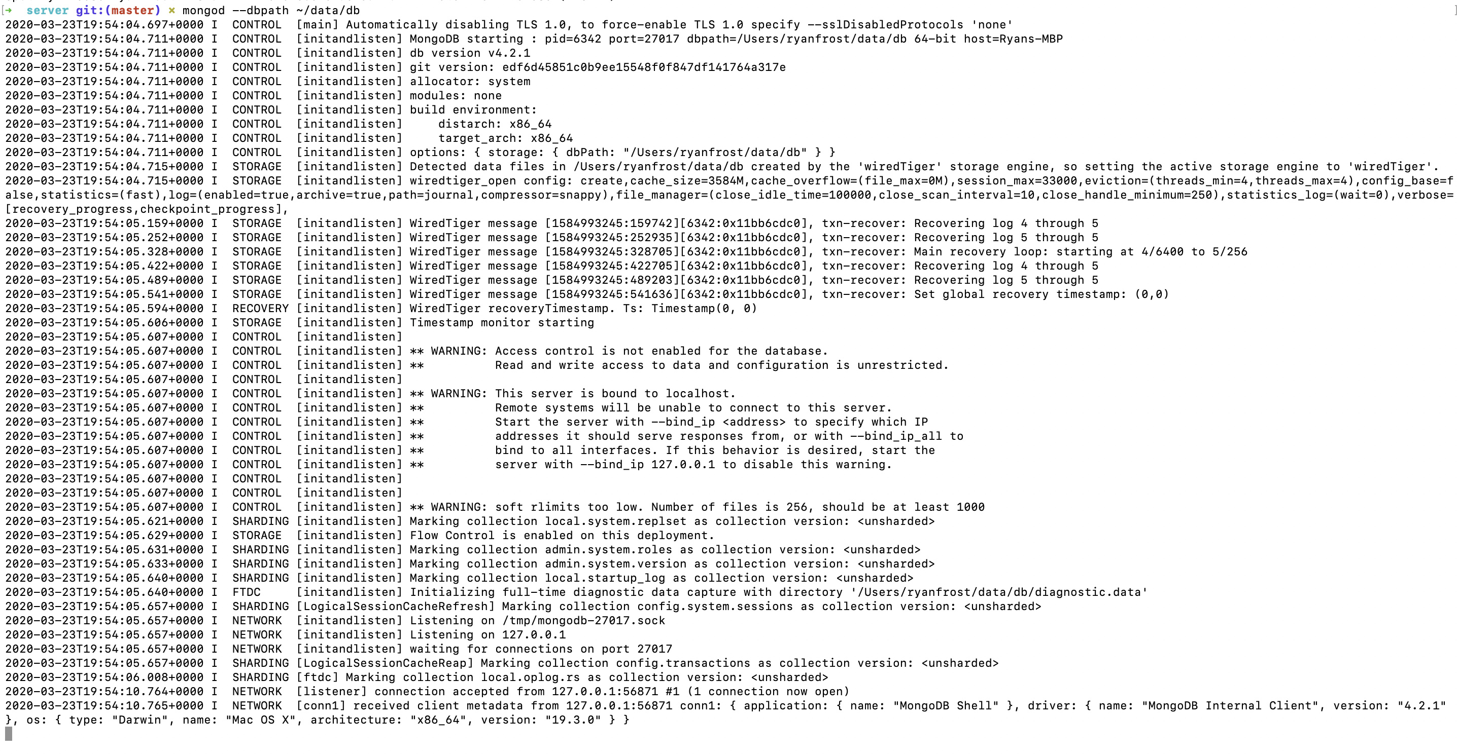

When I enter mongod --dbpath ~/data/db Terminal stalls on this:

Hi @Ryan_Frost the mongod command you ran will start the server and then log all output to the current terminal, unless you state where to write the log data.
At the bottom of that log (third line from the bottom) it says that the server is listening on port 27017. Since you’re bound to localhost (that information is towards the middle of the log file) you should be able to start a new terminal window and run the mongo command to connect to the database and open a new MongoDB shell.

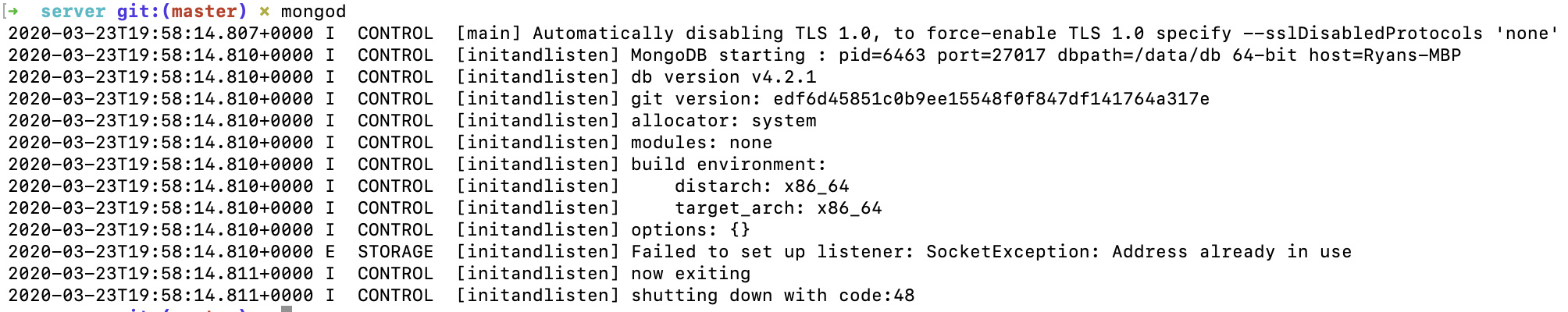

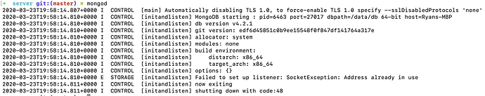

Ok so in the first image you get an error stating that the address is already in use. This happens if you try to run two different mongod commands without changing the port. In this case the second server shuts down as expected.

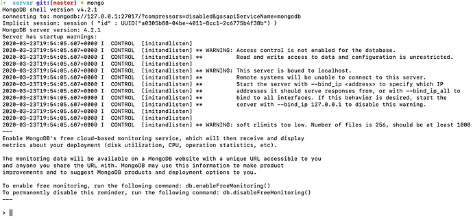

For the second image I see a running mongo session and it’s ready for you to start working. There are warnings (you see these in the original message as well) that you should look into if this will be a production server.
The final image is a log file with the last few lines showing that you did indeed connect to the server from a mongo shell.
From what you’re showing everything is working as expected.
