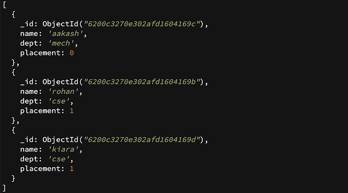

Hi @nancy_tyagi ,
Sorry mistakenly used some wrong field names. The following works for me:
db.collection.insertMany([{ "name" : "rohan", "dept": "cse" } ,
{ "name" : "aakash", "dept": "mech" },
{ "name" : "kiara", "dept": "cse" }]);
db.collection.aggregate([
$match : { dept : { $in : ["mech", "cse"]}}
$addFields :{ "placement" : { $indexOfArray: [ ["mech", "cse"] , "$dept" ] }}
{$sort : { placement : 1 } }
The result ireturned by query is as follows:
