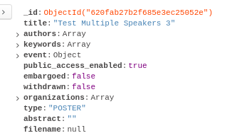

I am not yet aware of the details of the use case for this aggregation but perhaps it may be possible to use the compound operator with the filter option to replace the $match stage to achieve what you are after. There is a similar example of this being done on the filter section of the docs linked. I have created a similar environment with 2 test docs as follows:
/// Note: Only the event._id value differs between the 2 docs.
adb> db.search.find()
_id: ObjectId("6254f404b7829aa13d1b6c17"),
title: 'Test Multiple Speakers 3',
organizations: [
{ name: 'Massachusetts Institute of Technology' },
{ name: 'testorg' }
event: { _id: ObjectId("622e5fee874f59246a93951b") }
_id: ObjectId("6254f404b7829aa13d1b6c18"),
organizations: [
{ name: 'testorg' }
event: { _id: ObjectId("123e5fee874f59246a939abc") }
