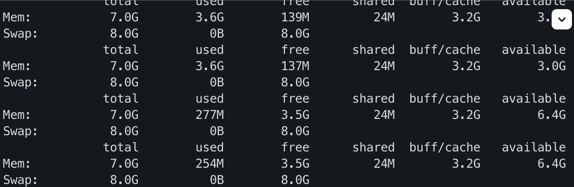

I am running a single instance of MongoDB 5.0.5 on a Virtual Machine running CentOS7 with 8Gb of RAM available. The machine is expected to receive a large number of connection and as I have learnt from here MongoDB roughly allocates 1Mb of memory per created connection, i.e. giving me a rough estimate of ~7000 max connections for the single instance. Is this reasoning correct? I noticed quickly that adding much more connection than that quickly leads to OOM kills. Adding a swap space prevents the OOM kills, but leads to DB crashes once too much memory is allocated on the swap. While I guess this is expected behaviour in the case of having >7000 connections, I am also seeing DB instabilities for far less connections (in the order of 4000) which should not lead to any problems as far as I can tell. Specifically, the database seems to become unreachable, even though enough memory seems to be available as can be seen in this free -h display:
The crash happens when there is still around 3Gb available, after wich the memory seems to be freed again. I also checked the number of available connections, but this also seems to be more than enough. In the /var/log/mongodb/mongod.log file I get the following BACKTRACE:
{"t":{"$date":"2022-01-07T02:11:19.677+01:00"},"s":"I", "c":"CONTROL", "id":31380, "ctx":"conn14209","msg":"BACKTRACE","attr":{"bt":{"backtrace":[{"a":"55C16D6730D5","b":"55C16980D000","o":"3E660D5","s":"_ZN5mongo18stack_trace_detail12_GLOBAL__N_119printStackTraceImplERKNS1_7OptionsEPNS_14StackTraceSinkE.constprop.357","s+":"215"},{"a":"55C16D675B69","b":"55C16980D000","o":"3E68B69","s":"_ZN5mongo15printStackTraceEv","s+":"29"},{"a":"55C16D66E3D6","b":"55C16980D000","o":"3E613D6","s":"_ZN5mongo29reportOutOfMemoryErrorAndExitEv","s+":"76"},{"a":"55C16D659991","b":"55C16980D000","o":"3E4C991","s":"_ZN5mongo12mongoReallocEPvm","s+":"21"},{"a":"55C16AD3491B","b":"55C16980D000","o":"152791B","s":"_ZN5mongo15BasicBufBuilderINS_21SharedBufferAllocatorEE15grow_reallocateEi","s+":"6B"},{"a":"55C16AD53C11","b":"55C16980D000","o":"1546C11","s":"_ZN5mongo3rpc17OpMsgReplyBuilder12reserveBytesEm","s+":"51"},{"a":"55C16AD6ABC7","b":"55C16980D000","o":"155DBC7","s":"_ZN5mongo12_GLOBAL__N_114RunCommandImpl3runEv","s+":"F7"},{"a":"55C16AD6CCAE","b":"55C16980D000","o":"155FCAE","s":"_ZN5mongo12_GLOBAL__N_119ExecCommandDatabase12_commandExecEv","s+":"1CE"},{"a":"55C16AD75840","b":"55C16980D000","o":"1568840","s":"_ZZN5mongo12_GLOBAL__N_114executeCommandESt10shared_ptrINS0_13HandleRequest16ExecutionContextEEENUlvE0_clEv","s+":"450"},{"a":"55C16AD77A30","b":"55C16980D000","o":"156AA30","s":"_ZZN5mongo15unique_functionIFvPNS_14future_details15SharedStateBaseEEE8makeImplIZNS1_10FutureImplINS1_8FakeVoidEE16makeContinuationIvZZNOS9_4thenIZNS_12_GLOBAL__N_114executeCommandESt10shared_ptrINSC_13HandleRequest16ExecutionContextEEEUlvE0_EEDaOT_ENKUlvE1_clEvEUlPNS1_15SharedStateImplIS8_EESN_E_EENS7_ISI_EEOT0_EUlS3_E_EEDaSJ_EN12SpecificImpl4callEOS3_","s+":"80"},{"a":"55C16AD32437","b":"55C16980D000","o":"1525437","s":"_ZN5mongo14future_details15SharedStateBase20transitionToFinishedEv","s+":"147"},{"a":"55C16AD7BDF2","b":"55C16980D000","o":"156EDF2","s":"_ZN5mongo14future_details10FutureImplINS0_8FakeVoidEE11generalImplIZNOS3_17propagateResultToEPNS0_15SharedStateImplIS2_EEEUlOS2_E_ZNOS3_17propagateResultToES7_EUlONS_6StatusEE0_ZNOS3_17propagateResultToES7_EUlvE1_EEDaOT_OT0_OT1_","s+":"152"},{"a":"55C16AD6F2BC","b":"55C16980D000","o":"15622BC","s":"_ZZN5mongo15unique_functionIFvPNS_14future_details15SharedStateBaseEEE8makeImplIZNS1_10FutureImplINS1_8FakeVoidEE16makeContinuationIvZZNOS9_4thenIZNS_12_GLOBAL__N_114executeCommandESt10shared_ptrINSC_13HandleRequest16ExecutionContextEEEUlvE_EEDaOT_ENKUlvE1_clEvEUlPNS1_15SharedStateImplIS8_EESN_E_EENS7_ISI_EEOT0_EUlS3_E_EEDaSJ_EN12SpecificImpl4callEOS3_","s+":"AC"},{"a":"55C16AD32437","b":"55C16980D000","o":"1525437","s":"_ZN5mongo14future_details15SharedStateBase20transitionToFinishedEv","s+":"147"},{"a":"55C16AD7622A","b":"55C16980D000","o":"156922A","s":"_ZN5mongo12_GLOBAL__N_114executeCommandESt10shared_ptrINS0_13HandleRequest16ExecutionContextEE","s+":"22A"},{"a":"55C16AD76C5E","b":"55C16980D000","o":"1569C5E","s":"_ZN5mongo12_GLOBAL__N_116receivedCommandsESt10shared_ptrINS0_13HandleRequest16ExecutionContextEE","s+":"1BE"},{"a":"55C16AD77976","b":"55C16980D000","o":"156A976","s":"_ZN5mongo12_GLOBAL__N_115CommandOpRunner3runEv","s+":"36"},{"a":"55C16AD71CA7","b":"55C16980D000","o":"1564CA7","s":"_ZN5mongo23ServiceEntryPointCommon13handleRequestEPNS_16OperationContextERKNS_7MessageESt10unique_ptrIKNS0_5HooksESt14default_deleteIS8_EE","s+":"307"},{"a":"55C16AD61B3F","b":"55C16980D000","o":"1554B3F","s":"_ZN5mongo23ServiceEntryPointMongod13handleRequestEPNS_16OperationContextERKNS_7MessageE","s+":"4F"},{"a":"55C16ADB9EF7","b":"55C16980D000","o":"15ACEF7","s":"_ZN5mongo9transport19ServiceStateMachine4Impl14processMessageEv","s+":"127"},{"a":"55C16ADBA227","b":"55C16980D000","o":"15AD227","s":"_ZZNO5mongo14future_details10FutureImplINS0_8FakeVoidEE4thenIZNS_9transport19ServiceStateMachine4Impl12startNewLoopERKNS_6StatusEEUlvE0_EEDaOT_ENKUlOS2_E_clESE_.isra.718","s+":"27"},{"a":"55C16ADBCB58","b":"55C16980D000","o":"15AFB58","s":"_ZN5mongo9transport19ServiceStateMachine4Impl12startNewLoopERKNS_6StatusE","s+":"1A8"},{"a":"55C16ADBD05F","b":"55C16980D000","o":"15B005F","s":"_ZZN5mongo15unique_functionIFvNS_6StatusEEE8makeImplIZNS_9transport19ServiceStateMachine4Impl15scheduleNewLoopES1_EUlS1_E_EEDaOT_EN12SpecificImpl4callEOS1_","s+":"7F"},{"a":"55C16CE38DA1","b":"55C16980D000","o":"362BDA1","s":"_ZZN5mongo15unique_functionIFvNS_6StatusEEE8makeImplIZNS_9transport26ServiceExecutorSynchronous18runOnDataAvailableERKSt10shared_ptrINS5_7SessionEES3_EUlS1_E_EEDaOT_EN12SpecificImpl4callEOS1_","s+":"41"},{"a":"55C16B485B83","b":"55C16980D000","o":"1C78B83","s":"_ZZN5mongo15unique_functionIFvvEE8makeImplIZNS_9transport15ServiceExecutor8scheduleENS0_IFvNS_6StatusEEEEEUlvE_EEDaOT_EN12SpecificImpl4callEv","s+":"33"},{"a":"55C16CE38F5B","b":"55C16980D000","o":"362BF5B","s":"_ZZN5mongo15unique_functionIFvvEE8makeImplIZNS_9transport26ServiceExecutorSynchronous12scheduleTaskES2_NS4_15ServiceExecutor13ScheduleFlagsEEUlvE0_EEDaOT_EN12SpecificImpl4callEv","s+":"BB"},{"a":"55C16CE3CE0C","b":"55C16980D000","o":"362FE0C","s":"_ZZN5mongo15unique_functionIFvvEE8makeImplIZNS_25launchServiceWorkerThreadES2_EUlvE2_EEDaOT_EN12SpecificImpl4callEv","s+":"5C"},{"a":"55C16CE3CE7C","b":"55C16980D000","o":"362FE7C","s":"_ZN5mongo12_GLOBAL__N_17runFuncEPv","s+":"1C"},{"a":"7F9B9F94CEA5","b":"7F9B9F945000","o":"7EA5","s":"start_thread","s+":"C5"},{"a":"7F9B9F675B0D","b":"7F9B9F577000","o":"FEB0D","s":"clone","s+":"6D"}],"processInfo":{"mongodbVersion":"5.0.5","gitVersion":"d65fd89df3fc039b5c55933c0f71d647a54510ae","compiledModules":[],"uname":{"sysname":"Linux","release":"3.10.0-1160.45.1.el7.x86_64","version":"#1 SMP Wed Oct 13 17:20:51 UTC 2021","machine":"x86_64"},"somap":[{"b":"55C16980D000","elfType":3,"buildId":"BFFEFC1C655BB329C72D082A0F159A3CE5FBF49F"},{"b":"7F9B9F945000","path":"/lib64/libpthread.so.0","elfType":3,"buildId":"E10CC8F2B932FC3DAEDA22F8DAC5EBB969524E5B"},{"b":"7F9B9F577000","path":"/lib64/libc.so.6","elfType":3,"buildId":"8DA9707D518E88179B1B2903CD846C82102D84C1"}]}}}}
The ‘reportOutOfMemoryErrorAndExitEv’ message seems to indicate to me that this is some kind of memory issue, but as you see from the screenshot above more than enough should be available at this point. I also checked if the mongod process is being OOM killed, but this is not the case as can be seen in the /var/log/messages file:
