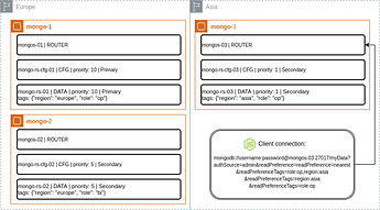

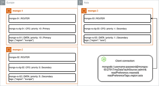

We have sharded cluster in two regions with one shard currently. There is no sharding enabled on the collections and balancing is off mode. Two servers in Europe and one in Asia. All servers are containing same setup with router, config server and data node.
Data nodes are one replica set with the primary in Europe
Config servers are one replica set with the primary in Europe.
MongoDB 4.4.0 is used. In data nodes we have tags named - region: “europe” and region: “asia” - depending region where the nodes are.
Client is a NodeJS with the 3.6 driver located in asia region and connects to this region router. Client uses readPreference=nearest&readPreferenceTags=role:asia
Client makes one specific query that does findOne query. In the router logs we can see that read preference is set. However, read request takes 200ms which means it tries to fetch data from europe region.
When we set client connection directly to the data nodes describing all replica set members and add same readPreference and readPreferenceTag then read request takes 3ms and data is retreived from asia as it supposed to do.

This problem I described is in our production. We tested with small NodeJS script this behavior also. When using only one readPreferenceTag then response times are always good (~3ms). But when adding multiple tags and failover in the client configuration then some requests are routed to other mongo data nodes. Time-to-time getting (~200ms)

We are using connection level read preference. Seems those parameters are not picked up. From Mongo router logs we can see those tags since connection level is logged in there. From network dump we can see that client do not send those tags nor readPreference to the router in the query level as we can see only readPreference: secondaryPreferred in there.
We needed to specify query level readpreferences.
