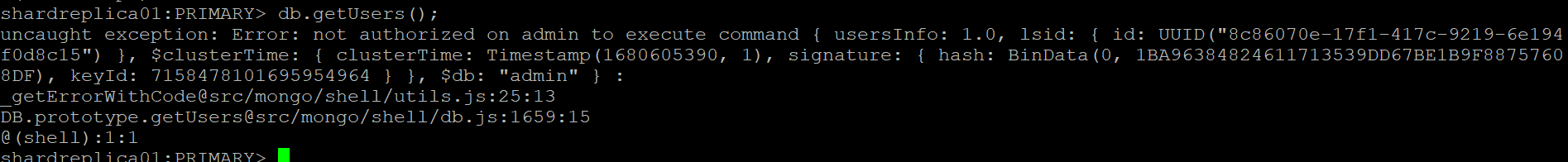

The users exist in mongos shell. but when I login sharded primary/secondary node getting bellow error.
“uncaught exception: Error: not authorized on admin to execute command { usersInfo: 1.0, lsid: { id: UUID(“8c86070e-17f1-417c-9219-6e194f0d8c15”) }, $clusterTime: { clusterTime: Timestamp(1680605390, 1), signature: { hash: BinData(0, 1BA96384824611713539DD67BE1B9F88757608DF), keyId: 7158478101695954964 } }, $db: “admin” } :

I can able to authenticate in mongos shell but I am getting error while tried to login mongodb sharded nodes like primary/ secondary
It means user does not have privileges on admin db

Hi @Nino_I ,
As mentioned from the documentation, you Need to create user in the primary of shard to perform operation directly on the shard.
These shard local users are completely independent from the users added to the sharded cluster via mongos . Shard local users are local to the shard and are inaccessible by mongos .
Direct connections to a shard should only be for shard-specific maintenance and configuration. In general, clients should connect to the sharded cluster through the mongos

Hi @Nino_I ,
as mentioned from documentation:
Sharded Clusters
compact only applies to mongod instances. In a sharded environment, run compact on each shard separately as a maintenance operation.
You cannot issue compact against a mongos instance.
So you need to create the correct user on each shard and than you can apply that operation.
