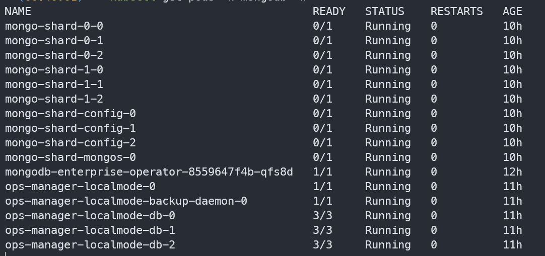

But status of my deployment is:
$ kubectl get pods -n mongodb
$ kubectl describe pod/mongo-shard-0-0 -n mongodb
Type Reason Age From Message
Warning Unhealthy 2m1s (x8190 over 10h) kubelet Readiness probe failed:
$ kubectl describe pod/mongo-shard-mongos-0 -n mongodb
Events:
Warning Unhealthy 3m8s (x8180 over 10h) kubelet Readiness probe failed:
Someone please help :pray:
