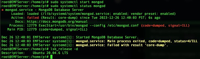

Hello, using this mongoDB guide I am trying to install Mongodb on my raspberry pi 3B+ (which says its supported) for a local network server. I installed Ubuntu 20.04.6 LTS which can be confirmed running lsb_release -d
and on the step where I start the mongod service sudo systemctl start mongod I run into this error after checking its status sudo systemctl status mongod
Are you using a Pi 3? I plan to eventually produce a binary for the Pi 3, but there are some complexities to doing so. The 3 is quite underpowered, so it is really stretching the boundaries of reality.
Yeah it was a pi 3. I did some digging around and came to the same conclusion that pi 3 is underpowered. It’s all good though, I have a pi 5 on the way but in the meantime had a pi 3 laying around thought I’d give it a try as it’s been on the way for a while now.
Unless you want to challenge yourself, I wouldn’t say it’s worth your time as majority of people are upgrading from the pi3 anyway.
