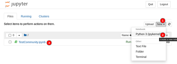

I just started a new Jupyter notebook in a new folder with the command: jupyter notebook
I created a new Python 3 notebook (ipykernel) using the web UI and gave it a name.

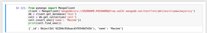

In the notebook I typed this: (I redacted my username and password)
Code:
from pymongo import MongoClient
client = MongoClient('mongodb+srv://USERNAME:PASSWORD@free.ne23r.mongodb.net/test?retryWrites=true&w=majority')
db = client.get_database('test')
coll = db.get_collection('coll')
coll.insert_one({'name': 'Maxime'})
print(coll.find_one())
And I ran the code and it was working out of the box. After some investigation, it’s actually working because I already have pymongo installed in the background with the dnspython lib. You can install them both with the command:
pip3 install pymongo[srv]
After this, I had to restart my jupyter notebook and rerun the code to make it work. Note that I’m using pip3 because I’m on Linux. Maybe it’s just pip on your system.
