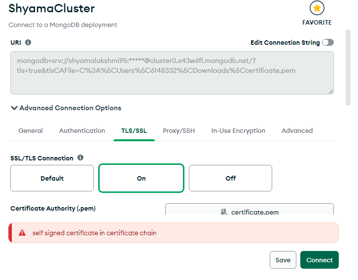

I can connect to my cluster without vpn, but the same cluster I can’t access from WVD showing error as Self Signed Certificate issue in certificate chain. I am not using any certificates to connect the cluster through WVD

Yah, its Windows virtual Desktop, from that environment getting issue. When local system connected to Global VPN also same problem arises
But you say there is no certificate installed with your MongoDB installation, self-signed or otherwise?
yah no certificate I installed during the creation of mongodb cluster
no certificate we are used while creating cluster account. And if we tried with allow access anywhere for testing purpose, at that time also WVD not connecting

Read the MongoDB FAQ: Security and make sure your VPN and operating system accept the Let’s Encrypt’s root Certificate Authority (ISRG Root X1)
Thank you for the update, Jack. I have a concern: can we directly use the ISRG ROOT X1 certificate, or do we need to generate a self-signed certificate for WVD? Will it solve our problem? We are currently stuck in our project. Could you provide a certificate for WVD testing purposes?
If I correctly understand your problem, @shyama_lakshmi , some part of your setup is not accepting MongoDB’s Let’s Encrypt certificate. I do not know where it is not being accepted … in your VPN security software? In WVD? I cannot tell from your description.
You should try first downloading the ISRC Root and install it in WVD and see if that works.
