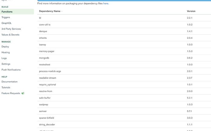

@Pavel_Duchovny I uploaded the driver and its dependencies, however I still get the error when I do:
var MongoClient = require('mongodb').MongoClient;
