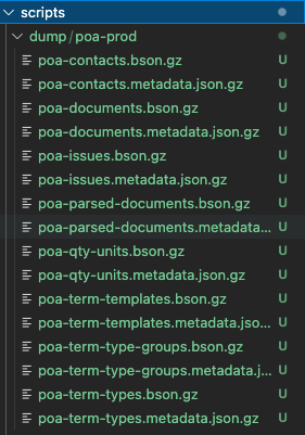

The dump appears to work. I’m seeing gzipped bson and metadata files for the expected collections in the /dump/{prodDatabaseName} directory.

mongodump creates the following directory and files…
Screen Shot 2022-02-09 at 7.55.45 AM
