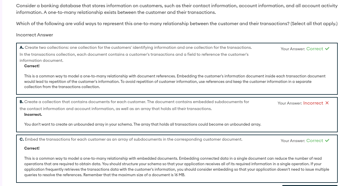

Can someone please help me understand what is the difference between option B and option C? My understanding is, both of those are suggesting that we embed transactions in customers. They why is B shows incorrect and C as correct?

The material and the explanation of the answer do both seem to be poorly written and somewhat confusing.
I believe the intent in B. and C. is to differentiate between embedding subdocuments one after another in a document (B), and placing the subdocuments in an array (C) rather that just tossing them into the customer one after another.
C. is a cleaner structure and easier to write validation for.
First of all, thank you for the explanation. I have a bit of confusion. I cannot seem to imagine the document structure differently for option B and C. What I am thinking is like this for both options,

Can you please give me the one example for option B and C according to your understanding?
I see. However, won’t there be a possibility of the transactions array going out of bound? Considering that, option A seems best to me. Can you please explain this?

The example you give is “C” … you have an array of transactions.
The quiz is suggesting you either create an array of transactions or create paired documents for each customer, one consisting of the customer info, and the other of the customer transactions.
I am unable to create a sample document structure according to the option B of the question. Can you please give me an example of option B?

It’s a little unclear what they’re trying to say in B … not terribly well written … but I believe they’re describing a messy antipattern where you create a document for each customer, with subdocuments for various customer information, then an array of transactions without a subdocument structure to each transaction.
