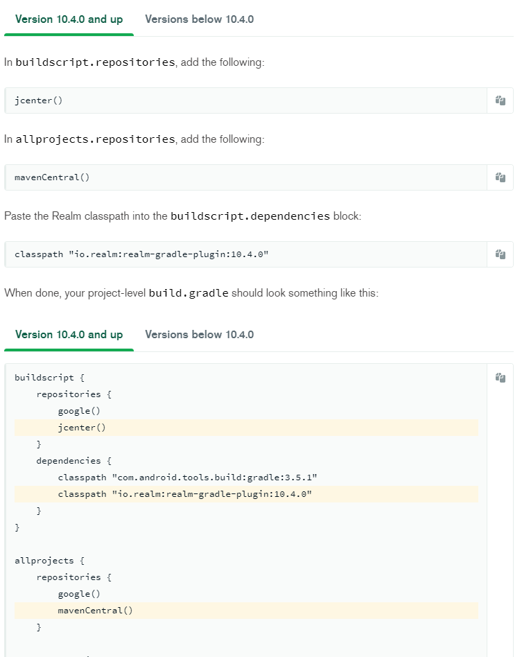

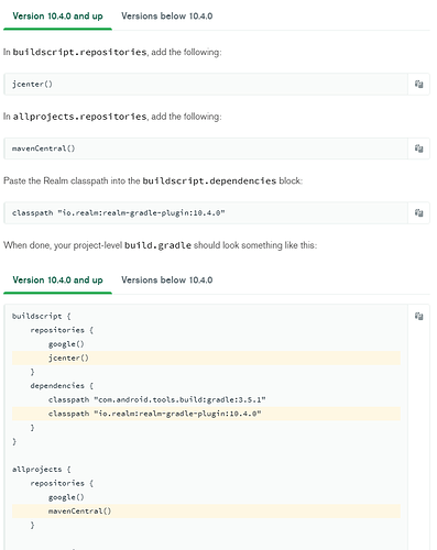

I have already upgraded to 10.4.0, but for the Realm recyclerview adapter 4.0.0 this is not on mavenCentral(), only jcenter, as far as I can tell.
Btw - here is a screenshot from your docs on 10.4.0 and up, note that it still references jcenter().
