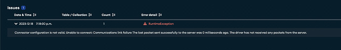

I am migrating data from MySQL to Mongo Atlas (One time migration).
Source URI:
jdbc:mysql://jamie:*****@localhost/hanndb?sslMode=disabled
Destination URI:
mongodb+srv://username:*****@somecluster.mongodb.net/database
The source URL is connected through a SSL Tunnel. I can connect to the MySQL db using MySQL Workbench and can execute queries.
The destination URL is on Mongo Atlas and I can connect using Compass.
In the migrator wizard I have confirmed using the “Test Connection” buttons. However once I execute the migration job I get the following error. I’m unsure what this error message means.
Hi @Jamie_Archibald, thanks for trying Relational Migrator, and sorry to hear you’re having problems.
When you say SSL tunnel, do you mean SSH tunnel? We haven’t tested this before, but if configured properly it should ideally be transparent to the drivers and workloads.
You could try looking in the migrator.log file to see if it has any additional details to help you troubleshoot.
There are also various SO articles describing problems and solutions with accessing databases over SSH tunnels that may be relevant (e.g. this one).
Tom
Hi Tom.
My database is an RDS MySQL instance hosted in AWS in a private subnet. I have a jump box in pubnet subnet which is internet facing.
I use the following command to setup and SSH tunnel (sorry typo, NOT SSL) to the jump server.
ssh -N -L 3306:hanndb-instance-1.caxokwegqpck.ca-central-1.rds.amazonaws.com:3306 -i “hann-ec2-server.pem” ec2-user@ec2-server.ca-central-1.compute.amazonaws.com
I’m able to connect both MySQL workbench and use telnet to connect to the database server on localhost:3306.
The Test connection works as well in Migrator but once the migration job runs it fails with that above error.
