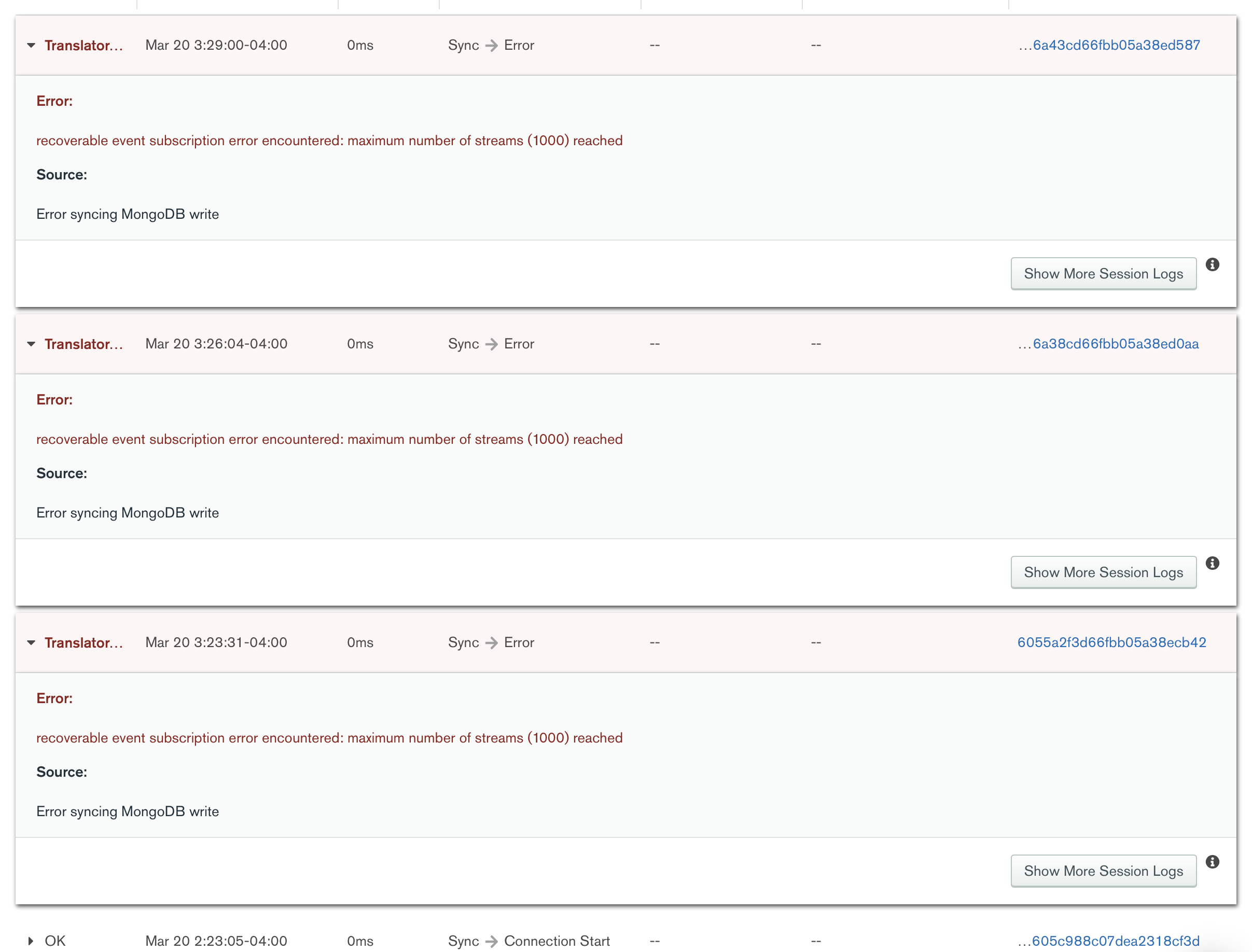

Here’s the error text showing in console
TranslatorFatalError Error Mar 20 3:29:00-04:00 0ms SyncError
6055a43cd66fbb05a38ed587
Error: recoverable event subscription error encountered: maximum number of streams (1000) reached
Source: Error syncing MongoDB write

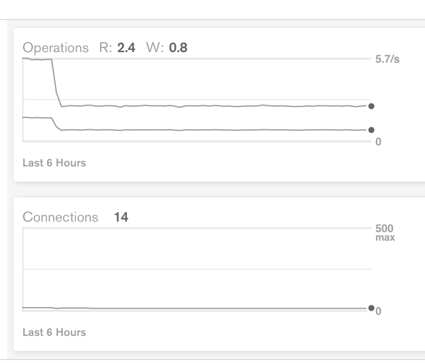

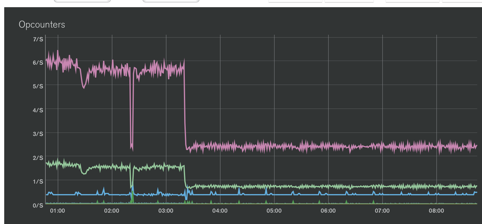

And some screenshots of the actual error, and then the activity. As mentioned this was not caused by the app but it appears it’s a server level event - which if so, should not generate an error (I would think) unless it was really an error.
Any thoughts?

This was a temporary issue affecting some clusters, and has since been resolved.

I was more looking for clarification about the cause of the error and what the error messages mean and what the effect was/is. The errors in console are often a little vague so what action should be taken, if any, is unclear. For example, what does this mean?
Does that mean someone s DDOS’ing us or does it mean server failed on a backup (for example)? Should I restart my instance? Is my data intact? Wouldn’t this be more clear…
Error: recoverable event subscription error encountered: maximum number of streams (1000) reached. The server temporarily paused a backup. No data was affected and it does not require any further action.

Hi @Jay,
This error was due to a backend configuration limit on the sync translator service for your cluster which has been adjusted. The detail on number of translator streams is from a part of the backend sync service you don’t control, so unfortunately there currently isn’t a lot of context for error messages like this unless the person reviewing the logs is a support engineer.
The impact is that you would need to restart the sync service per the email notification you received (which should have included a link to follow).
