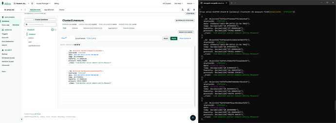

How it looks on website and on mongo shell:
There are visible empty divs which should contain data

Here are results of find() command:
Atlas atlas-6nd759-shard-0 [primary] Cluster0> db.measure.find({ stationId: "2767224" })

I don’t know if it is possible to insert document with invalid date via cli, I know that on website it’s not possible.
You might have to use example server app to reproduce issue - I have spring boot server which connects to Mongodb. If you would like to use it I can provide link to github.
Example bad date send to server which results in not-displayable document is:
-5149169-04-23T14:56:57Z
Currently I fixed my esp8266 program so I now have right date, but still it should be possible to delete documents with bad data via website.
Thanks for providing those examples. I can see to some degree what you mean now. I was not able to insert via mongosh an invalid date for example but was able to bring up the Invalid Date value:
test> var test = new Date("-5149169-04-23T14:56:57Z")
test> test
Invalid Date
Inserting documents with this value seem to revert to a default of ISODate("1970-01-01T00:00:00.000Z") instead of Invalid Date.

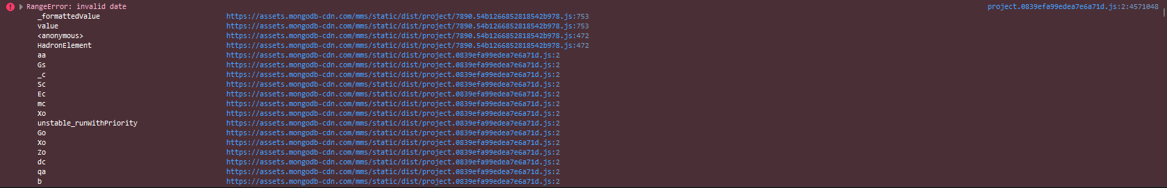

I checked the console and there is range error for each document with invalid date:
