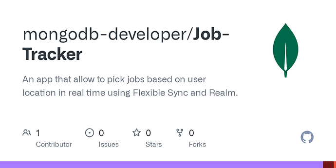

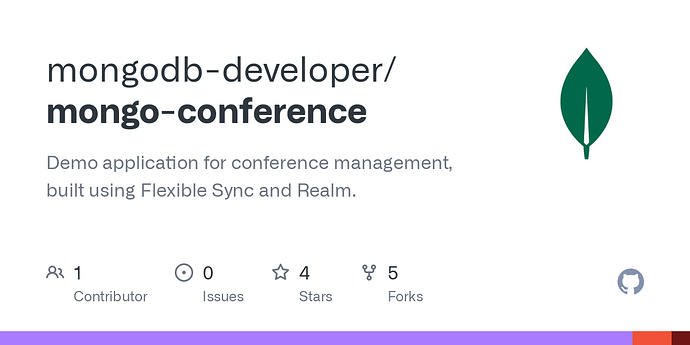

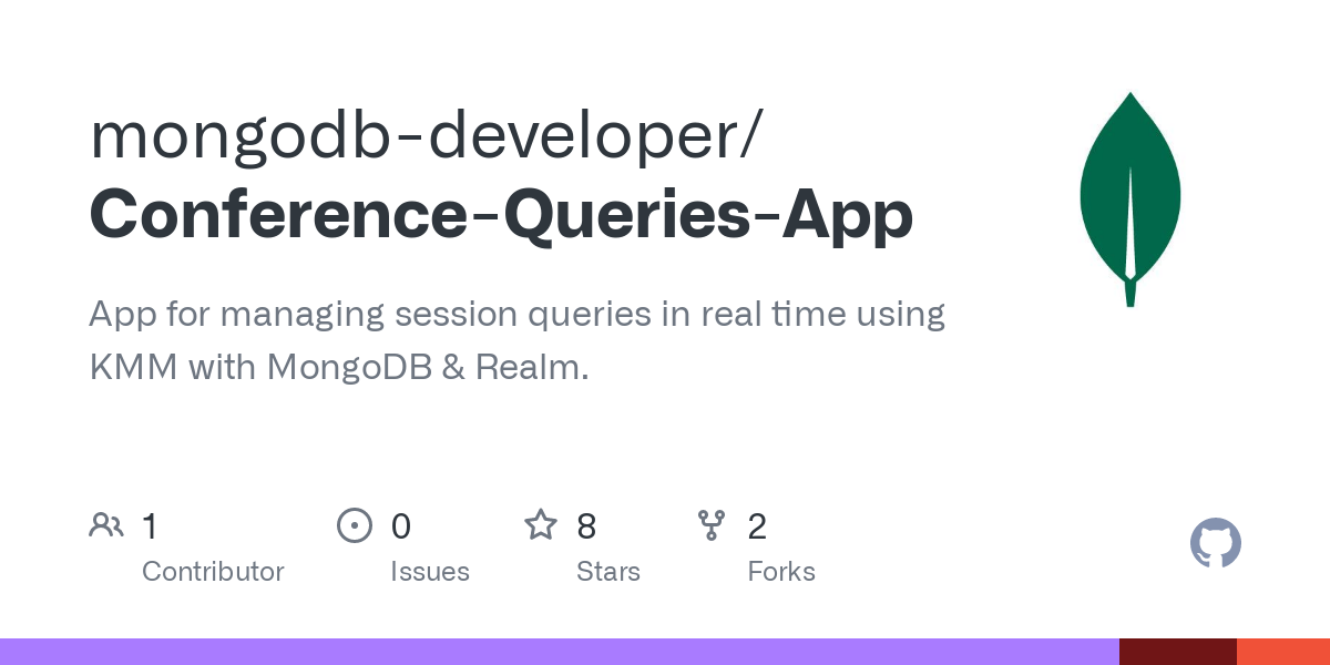

Nice to see one more KMM enthusiast here. Sharing a few of my repo’s for your reference
