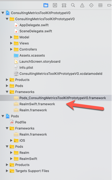

I looked at the two errors which centered around not being able to find Realm.framework and RealmSwift.framework in my project
That’s a different issue than what was originally asked (about crashing on a real device with an out of bounds error). Can you clarify how that ties in?
Jason, thank you for the suggestions. You have given me some good things to look at. I am waiting on a new power supply for my MacBook but will get back with you after it arrives and I can get back to my code. Thanks again. I will put updates on the Realm forum also.
I have resolved the two errors about not being able to find the Realm.framework and the RealmSwift.framework. I had to move them in my workspace to be after the the definition of the Pods_appname.framework in the Frameworks folder. For some reason they were sitting above the Pods-appname.framework. That resolved the missing frameworks. I also went back to verson 4.4.0 in the podfile with the statement: pod ‘RealmSwift’, ‘4.4.0’
