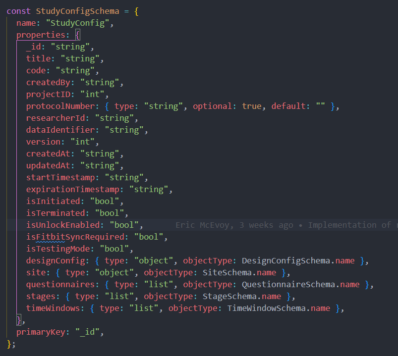

Hi, will this suffice?
What is the schema for StudyConfigSchema?
It is this one
