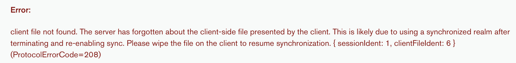

Now Realm.asyncOpen on the private realm doesn’t execute its callback at all. I’m expecting it to execute the callback with an error so that I can handle it in the app.
MongoDB Realm log shows:
Error:
client file not found. The server has forgotten about the client-side file presented by the client. This is likely due to using a synchronized realm after terminating and re-enabling sync. Please wipe the file on the client to resume synchronization. { sessionIdent: 2, clientFileIdent: 29 } (ProtocolErrorCode=208)
How would I know to delete the file if the API doesn’t actually tell me to do so?
Also, the realm file is actually found on the device. FIleManager.default.fileExists(at: path) reports true
I don’t understand if this error can happen in production and how to mitigate it. How can you deal with schema migrations if you don’t have a migration block? you can’t just wipe user’s data because you added a field in an object can you?

The log directs me to delete the Realm client side but this poses several questions which my post is looking for an answer to:
  1. How would I know to delete this realm if AsyncOpen doesn’t report this error
  2. Is this error possible to happen while the app is live (it currently isn’t live) - by live I mean that there a version of it actively being used
  3. What would happen with the unsynced data on the device? If I’m deleting the realm then I’m wiping the user’s unsaved data
  4. Why is the log saying the client file is not found when FIleManager.default.fileExists(at: path) reports that the realm file indeed exists. Or is this client file something else than a realm file.

We see a different behavior across our apps and I am not sure what the difference is between our code and your code.
Our experience is when Atlas gets our of sync, it throws an error which can be seen in the console and our app receives that error as well.
I just tried it now with a destructive change; I added a property to a test object called “propertyToDelete” and then added some objects. After a moment it sync’d and the objects appeared in the console.
Then we went into the console->Realm->the app->schema and deleted that property. Upon saving, it generated an error in the console (as expected)
The changes you are trying to save are destructive and will require Sync to reinitialize.
Then we saved, let it reinitialize and ran the app. The console log shows this error
and when we run our code it shows a matching error in the Realm.asyncOpen function
2021-05-16 09:46:24.288551-0400 TestApp[95487:3157327] Sync: Connection[1]: Session[1]: Received: ERROR “Bad client file identifier (IDENT)” (error_code=208, try_again=0)
Failed to open realm: The server has forgotten about this client-side file (Bad client file identifier (IDENT)). Please wipe the file on the client to resume synchronization
2021-05-16 09:46:24.296675-0400 TaskTracker[95487:3157327] Sync: Connection[1]: Disconnected

Any luck on resolving why asyncOpen doesn’t call its callback? I’m having the same issue though the root cause is only because I terminated the sync and re-initialized (reason why I terminated the sync sounded like a one-time issue. More on this here: https://github.com/realm/realm-cocoa/issues/7478)
Here’s what I’m doing in short:
  1. Download the latest Realm on app launch. Download succeeds. I kill the app
  2. On the Realm web UI, I terminate the sync and re-initialize
  3. Cold start the app. The app loads normally. After a second or two, Realm throws this error: ERROR "Bad client file identifier (IDENT) … "
  4. I catch this error via the SyncManager’s errorHandler. Then,
  5. Close (I think) all Realm instances. Then,
  6. Invoke SyncSession.immediatelyHandleError. Then,
  7. I used FileManager to move the backed up realm to be later restored (I also skipped this part after reading it’s not necessary. This didn’t fix the issue). Finally,
  8. With a one second delay (I tried without the delay too), I invoke Realm.asyncOpen to download the new realm and restore the backup. This callback never gets called

I tried something else and got this error
- failure : Error Domain=io.realm.unknown Code=211 "The client and server disagree about the history (Diverging histories (IDENT)). Please wipe the file on the client to resume synchronization" UserInfo={Category=realm::sync::ProtocolError, NSLocalizedDescription=The client and server disagree about the history (Diverging histories (IDENT)). Please wipe the file on the client to resume synchronization, Error Code=211}
Instead of Reopening the realm Async (step #7 of my last reply) I logged out the user and logged them back in. After logging in successfully, I invoke Realm.asycOpen and that’s when the error was thrown
Perhaps this alone isn’t enough to handle the clientResetError?
