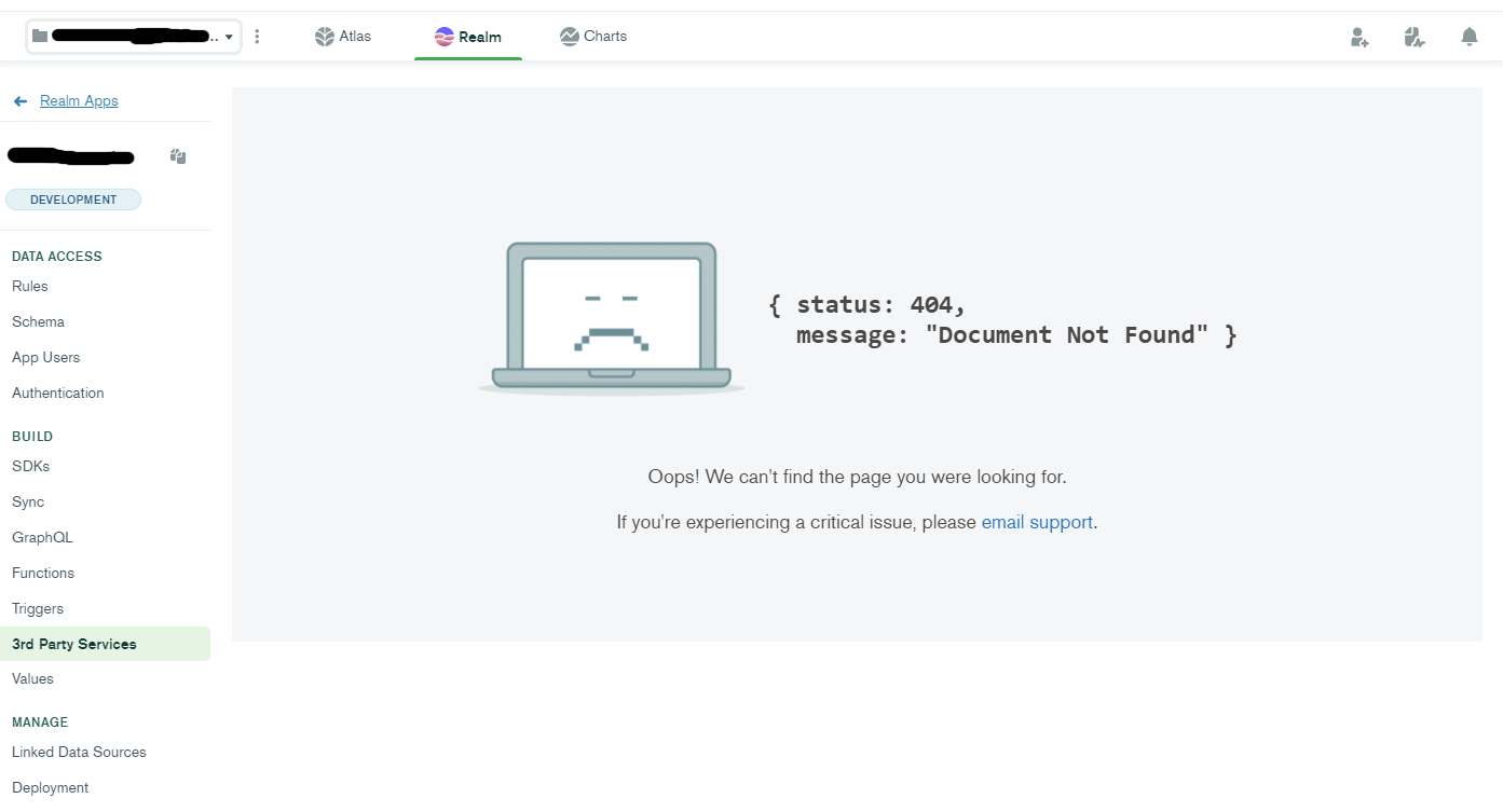

Hi @Andrew_Morgan. Well that got me a step forward in that importing the new file structure did actually hook up to the cluster but there are still some serious issues.
- all of my schema rules have gone missing - according to the UI there are no schema rules defined
- all of my http services have gone missing - clicking on 3rd party services and http displays a 404 error page:
I’m going to try and roll back to the previous version again.
