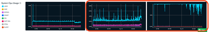

Currently I have set up a simple replica set with three nodes and readPreference value is “secondary”. Monitoring cpu usage between the two secondaries, I notice one is under 8% and one is almost 100%. My question is why such difference exists? Should it be 50-50 or something similar? If this is not normal then what is the possible reason for it, as well as the solution to fix our problem? Thank you.

I asked the teams using our database and this may be the reason. There’s currently only one very active microservice which is responsible for making 95% of the queries to our database. May be that’s why most of the queries only go to one member of secondaries?
I would suggest you create your own scripted read workload to work over a minute and run a copy of it 3-5 times at least to benchmark your cluster. this way you should see a distributed reading from both secondaries. A nodejs or python script will be the fastest choice I guess.
and as for the microservice, yes, they usually tend to create a pooling to a node when they start and use that pool until they crash or shut down. and you have only 1 of them running it seems. I haven’t thought about this before but this is clearly a bottleneck. I don’t have an answer to optimize this.
