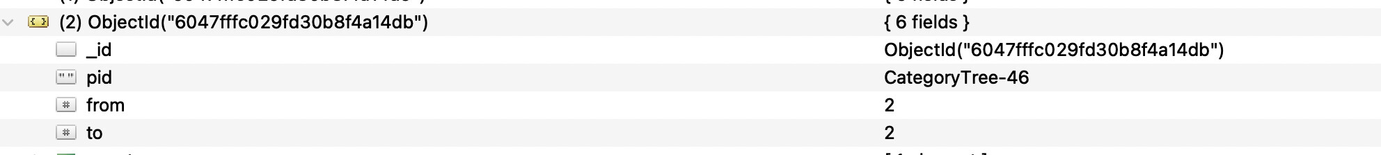

Our application uses Mongo as journal (event sourcing), on which each document has an aggregate id field, a from and to fields

But, when doing an explain over that query we’re not getting the best ratio on totalKeysExamined:totalDocsExamined:nReturned. For example, he explain for the above query is:
  "docsExamined": 9,
  "nreturned": 9,
  "keysExamined": 24300
Any suggestion in how to tune our index or our query in order to improve that ratio?

@Prasad_Saya in that collection there is near 6 million documents at this moment. As we use event sourcing with snapshots, a typical query run returns always between 1 and 10 documents.
First our application scans for a snapshot document on our snapshot collections, and then it retrieves from our journal collection the N latest documents, that as I said, are between 1 and 10 documents.
