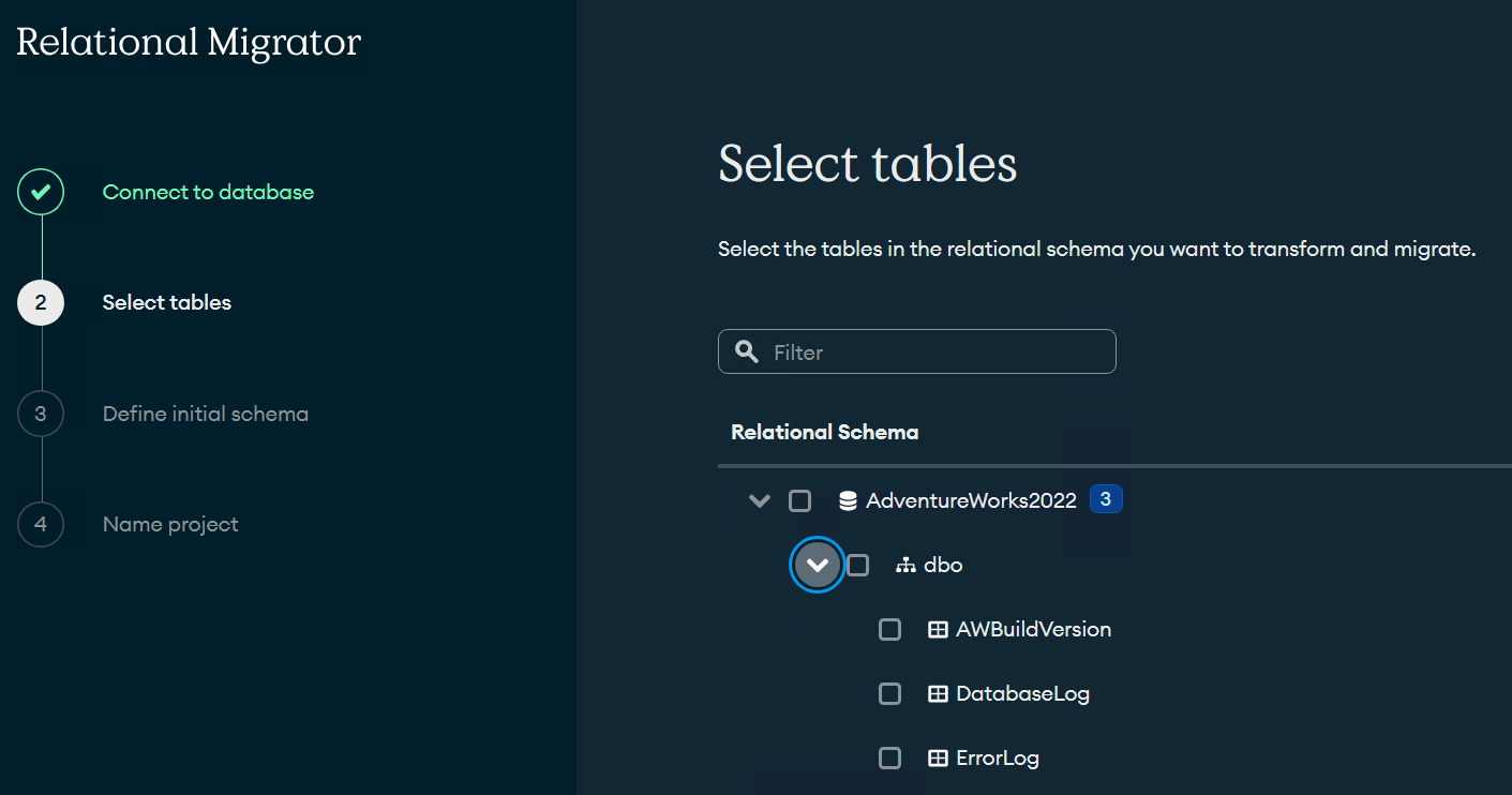

I am doing some POC to migrate the SQL Server database to MongoDB Atlas using the MongoDB Relational Migrator tool.
I could see the tool by default is not able to detect the tables under user-created schema in the SQL Server. I am able to see the tables under the default schema (dbo) but not the other tables.
Here is the screenshot from the SQL Server side where I have another set of tables
Anyone else encounter something similar? Can you please suggest?

Hi @Naveen_Kumar2 -
Ah, AdventureWorks - almost as fine a schema as Northwind!
For a reason I’ve never fully figured out, the SQL Server driver only pulls tables from the dbo schema when you connect to all databases. However if you specify a database name on the connection page (or via the databaseName JDBC parameter) the tool is able to load data from all schemas.
HTH
Tom

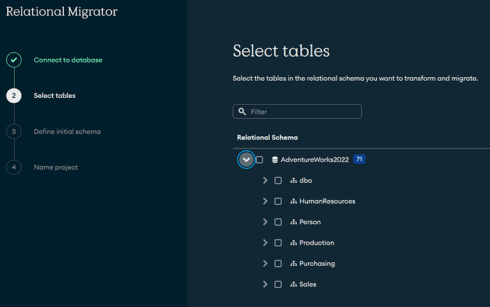

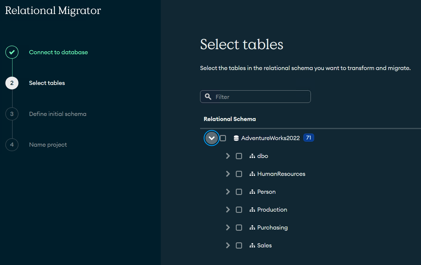

Thanks for your help @tomhollander !
After providing the database name, now I am able to list all schemas and the tables underneath it
I will continue to explore the tool :slight_smile:
