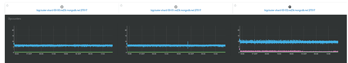

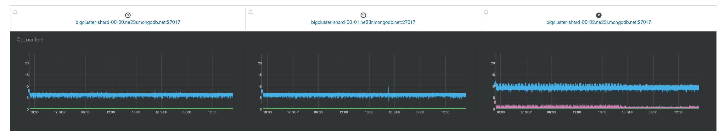

Totally!
I think this script is trying to reproduce what mongostat is doing and it would also be much easier to plot these values to get something like what we have built-in MongoDB Atlas.
