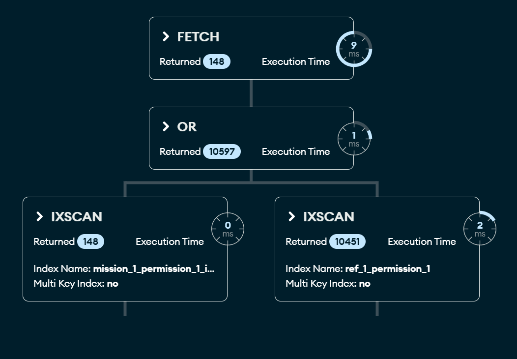

Explain Visualized:

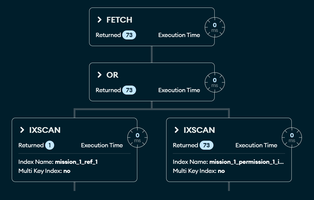

As you can see the IXSCAN on the left correctly used the { mission: 1, permission: 1 } index, but the one on the right does not pick up the { mission: 1, ref: 1 } index and instead picks up { ref: 1, permission: 1 } .
If I go ahead and delete the { ref: 1, permission: 1 } index, then it picks up the correct index, as seen below.
