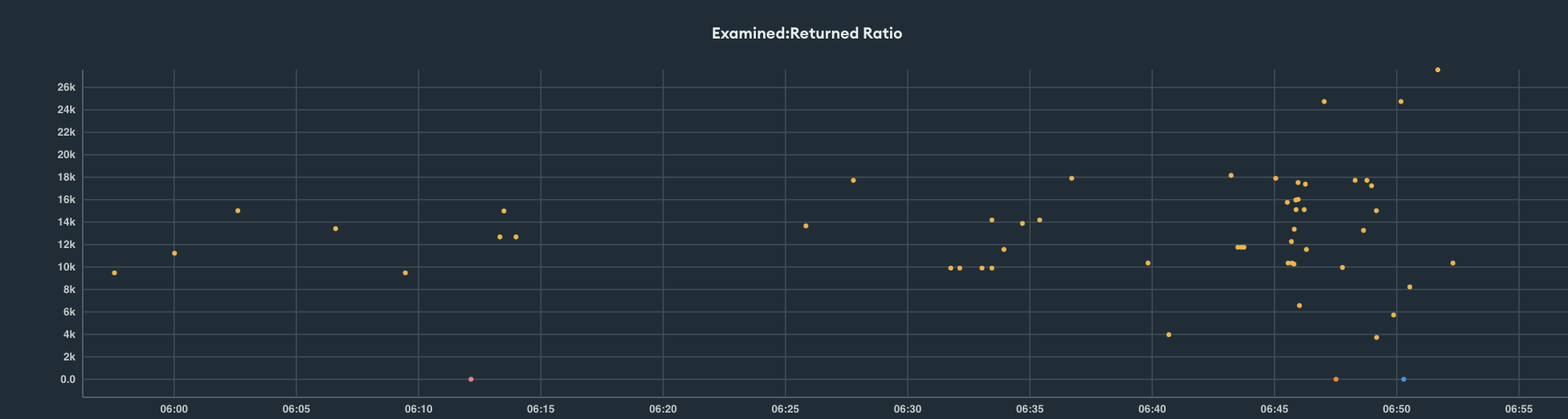

When looking at the profiler and selecting Examined:Returned Ratio, we have found a few queries that we know of that have a ratio greater than 1k. They are all indexed, but maybe we need to improve them since during the execution of many queries, they appear but no alert is triggered.

It seems that there was a spike in the monitoring chart last night, but nothing showed up in the profiler.
However, when there was a lot more traffic on our site last hour, the profiler showed a lot of queries with the same Examined:Returned Ratio issue (mostly the same query, but one that we know of and can’t do much about at the moment) but we didn’t receive any alert, so my guess is that it’s based on the average for a certain period.
