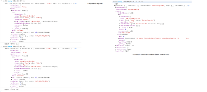

We’re currently not experiencing the issues on the larger page. However we are definitely experiencing duplicate requests - made even more evident by logging the apollo requests (attached).

As for duplicate requests here’s two IDs from just a moment ago - the ones in the image of the requests.
First Request: 60e62a3d59a8cc572e706b37
Second Request: 60e62a3d901e466e2004493d
As for logs, hopefully these apollo request logs will suffice?
Smaller page (duplicate requests being logged) are on the left
Larger page - sending one request on initial load as expected - is on the right
We’re going to continue monitoring the larger page, as before it would be fine for a bit but throttle us quickly.
The app url would be great (looks like this - App Services)
If I’m reading the image right, it seems like the duplication is happening on the client. Is it possible that something is going on in the apollo client implementation that is logging the duplicate request rather than an issue in Realm?
