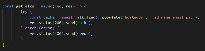

I am basically trying to authenticate a user token, return that user, and retrieve a list of ‘talks’ from the database
Here is the controller of the route am testing

I don’t think there is an issue with the schemas, the problem I am having is with the authorize method when I have to return the user
mongoose adds _id of type ObjectId since there’s not one defined in the Schema. If you are not passing _id in request body from Postman then you shouldn’t be seeing that error. Could you please step through the service code to see where exactly the exception is being thrown?
hey…so the issue is not with the authorize method. The issue is with the route for some weird reason. I found out that when I use this “/” route in Postman, it collects the data just fine. When I write anything after the slash like “/talks” it throws the same error again. Why do you think that may be? I mean this is a standard get API call, I shouldn’t be having such difficulty getting data
