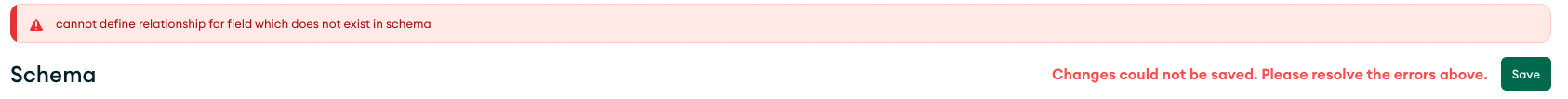

Now, I decided to remove it manually from the Schema UI, but the following error pops up when I try to save:

Error is the following: “cannot define relationship for field which does not exist in schema”
This likely means that you still have a relationship that references the property you’re trying to remove. From the schemas tab, there’s should be a toggle labeled “Expand relationships”, if you turn that on you’ll be able to see the relationships defined on your table, and remove the ones that you no longer need. See https://www.mongodb.com/docs/atlas/app-services/schemas/relationships for additional details.
