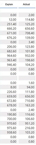

Yes, the execution times obtained in milliseconds are listed in the following tab. On the left side: the explain results and on the right side: the actual execution observed.
To be more precise: the right side of the previous tab is obtained with the java program coded this way.

Here is the tab including the shell values :
| avg explain time | avg java time | shell time |
| 0.00 | 2.00 | 84 |
| 12.00 | 114.80 | 531 |
| 251.40 | 125.20 | 406 |
| 666.20 | 656.60 | 725 |
| 671.00 | 708.40 | 45 |
| 676.20 | 139.00 | 14 |
| 0.00 | 3.40 | 15 |
| 206.00 | 123.80 | 18 |
| 682.60 | 101.80 | 24 |
| 964.60 | 932.00 | 1008 |
| 963.40 | 198.60 | 24 |
| 946.40 | 104.20 | 13 |
| 0.00 | 0.80 | 8 |
| 0.00 | 0.80 | 10 |
| 0.00 | 1.60 | 3 |
| 8.00 | 94.00 | 28 |
| 226.60 | 111.80 | 34 |
| 659.00 | 656.00 | 724 |
| 672.80 | 710.80 | 104 |
| 678.00 | 163.20 | 13 |
| 0.00 | 2.40 | 4 |
| 190.80 | 116.60 | 20 |
| 700.00 | 106.60 | 18 |
| 970.60 | 951.20 | 1152 |
| 975.60 | 216.00 | 17 |
| 938.60 | 1036.20 | 15 |
| 0.00 | 0.80 | 1 |
| 0.00 | 0.80 | 2 |
