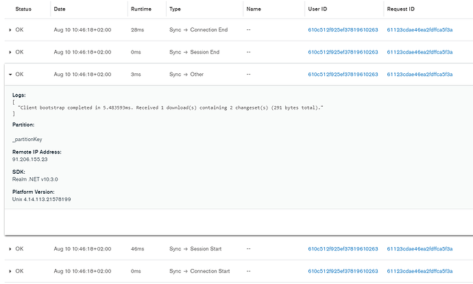

I am starting my adventure with Mongo Realm yet I have encountered some problems. This is my first post and I am not entirely sure if I should post this kind of issue here. I have created Xamarin.Forms app in Visual Studio installed the Nuget for the realm and tried to connect to my RealmApp via sync. I am debugging my app on my phone and as long as the connection establishes, everything is fine but write operations upload records only to local Realm and not syncing . Also, query operations do not return this one little record I written to atlas
Here are some parts of the code and screenshots of the problem.

Hello @Dominic_Frei and thank You for your response!
Unfortunately, the method now throws:
Realms.Exceptions.RealmException: ‘A system error occurred while opening a Realm. See InnerException for more details.’ Source=mscorlib

Ah, perfect. Thank you for that!
I’ve run it locally and can 100% reproduce your problem.
To make it a bit easier to read I’ve updated the LoginViewModel to print the error:

But you might as well just set a breakpoint and look at the inner error (which is the one raised by our Core framework, not the .NET SDK - we print them out as well to make your debugging as easy as possible).
It’s maybe not all to obvious at first but the error in log will then look like this:
Realms.Exceptions.RealmException: A system error occurred while opening a Realm. See InnerException for more details. ---> Realms.Exceptions.RealmException: The following changes cannot be made in additive-only schema mode:
- Property 'User._partitionKey' has been made optional.
- Property 'User.emailAddress' has been made optional.
- Property 'User.password' has been made optional.
- Property 'User.username' has been made optional.
--- End of inner exception stack trace ---
You have made changes to your model that need to be reflected in Atlas as well.
Since you are still in development I’d recommend turning on development mode so you can easily just do all the schema changes from within your app’s code without having to worry about defining and migrating a schema in Sync / Atlas.
Further documentation for this:
Yes! That was the issue. I did not add [Required] tag to my RealmObject model inherited class properties. Thank You a lot!
No problem at all. Glad to hear everything works now.
