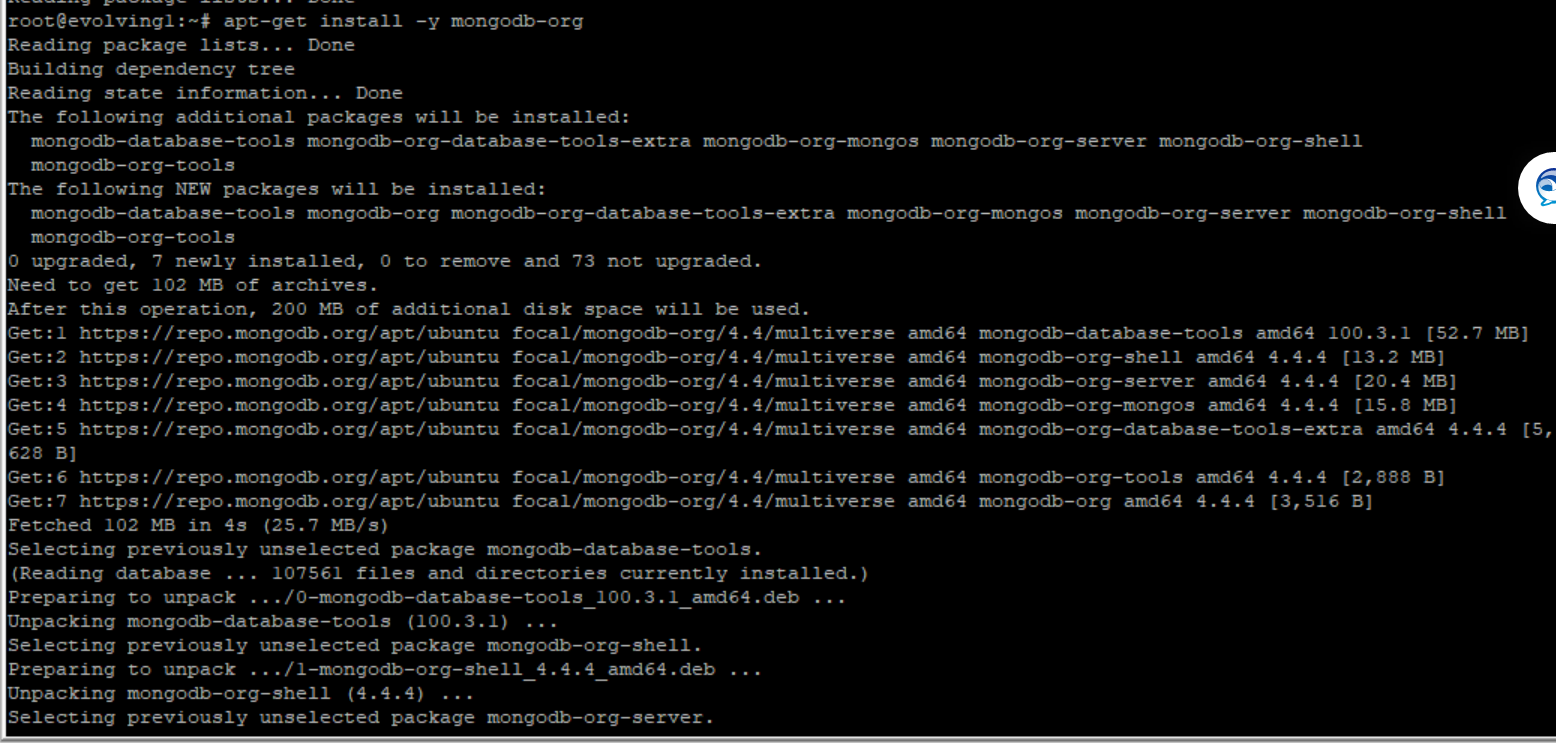

Hi @jon_rawlins,
I tried above mongodb link on which worked for me.

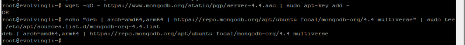

I am also experiencing this issue trying to install MongoDB 4.4 on Ubuntu 20.04LTS … This mentions no release file for focal when I try apt update (after adding the PGP key of course). @jon_rawlins did you find a workaround for this?
the fix for this to change this line… basically remove 4.4 on the saved file …
echo "deb [ arch=amd64,arm64 ] https://repo.mongodb.org/apt/ubuntu focal/mongodb-org/4.4 multiverse" | sudo tee /etc/apt/sources.list.d/mongodb-org-4.4.list
to this
echo "deb [ arch=amd64,arm64 ] https://repo.mongodb.org/apt/ubuntu focal/mongodb-org/4.4 multiverse" | sudo tee /etc/apt/sources.list.d/mongodb-org.list

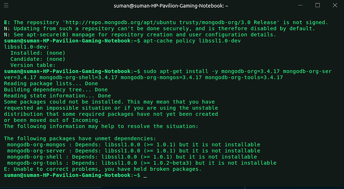

Hopefully, this can be helpful for installing MongoDB version 3.4.17
Try this:
echo "deb http://repo.mongodb.org/apt/ubuntu xenial/mongodb-org/3.4 multiverse" | sudo tee /etc/apt/sources.list.d/mongodb-org-3.4.list
sudo apt update
apt-cache policy libssl1.0-dev
sudo apt-get install libssl1.0-dev
sudo apt-get install -y mongodb-org=3.4.17 mongodb-org-server=3.4.17 mongodb-org-shell=3.4.17 mongodb-org-mongos=3.4.17 mongodb-org-tools=3.4.17
