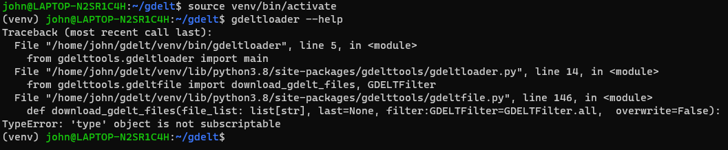

@Mark_Smith I keep getting this error while trying to use gdeltloader on my Ubuntu (on WSL)
I’ve tried uninstalling and re-installing gdelttools but nothing’s changed.
My Python version is 3.8.10 and Ubuntu 20.04.4 LTS.

Thanks for letting us know about this @Fiewor_John. This is a bug that’s been introduced in a recent version of gdeltloader - it looks like it no longer works with Python 3.8.
I’ll fix the bug, but it’ll take a little while to publish. In the meantime, you can update to Python 3.10 to fix this problem. I’m sorry about this!

Thank you. Updating to Python 3.10 as suggested worked.
