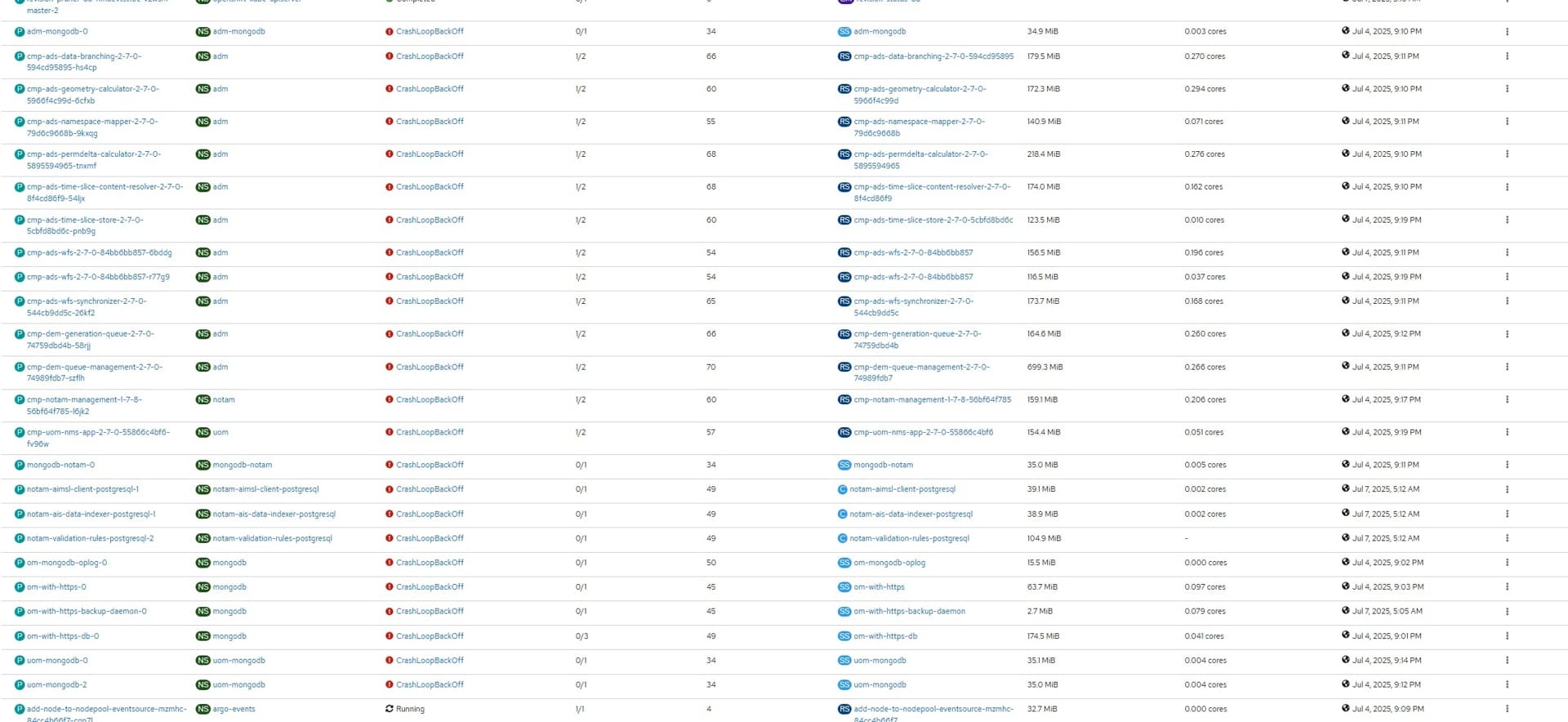

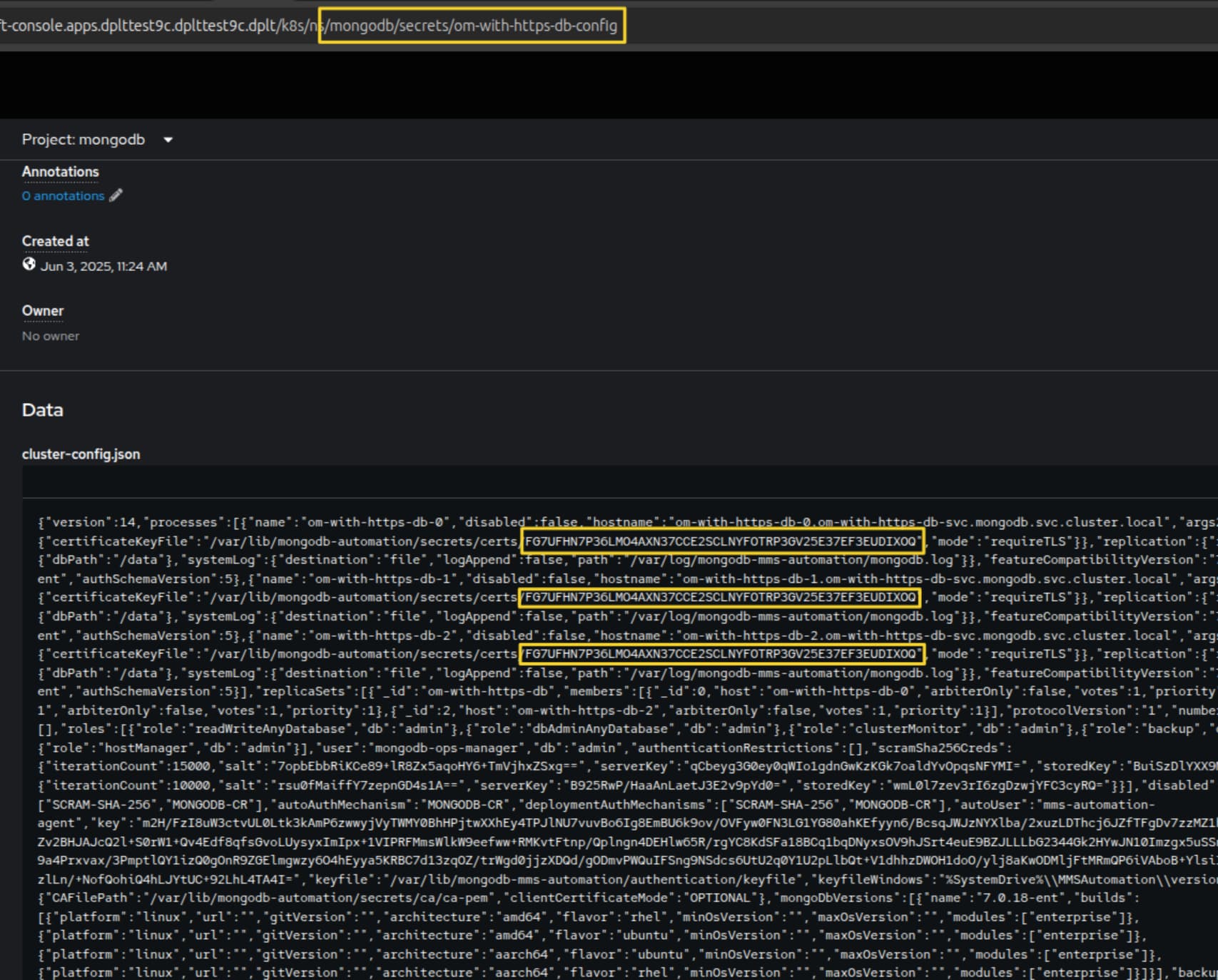

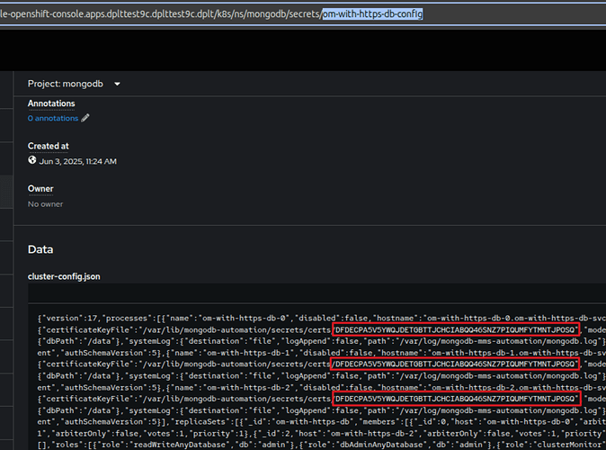

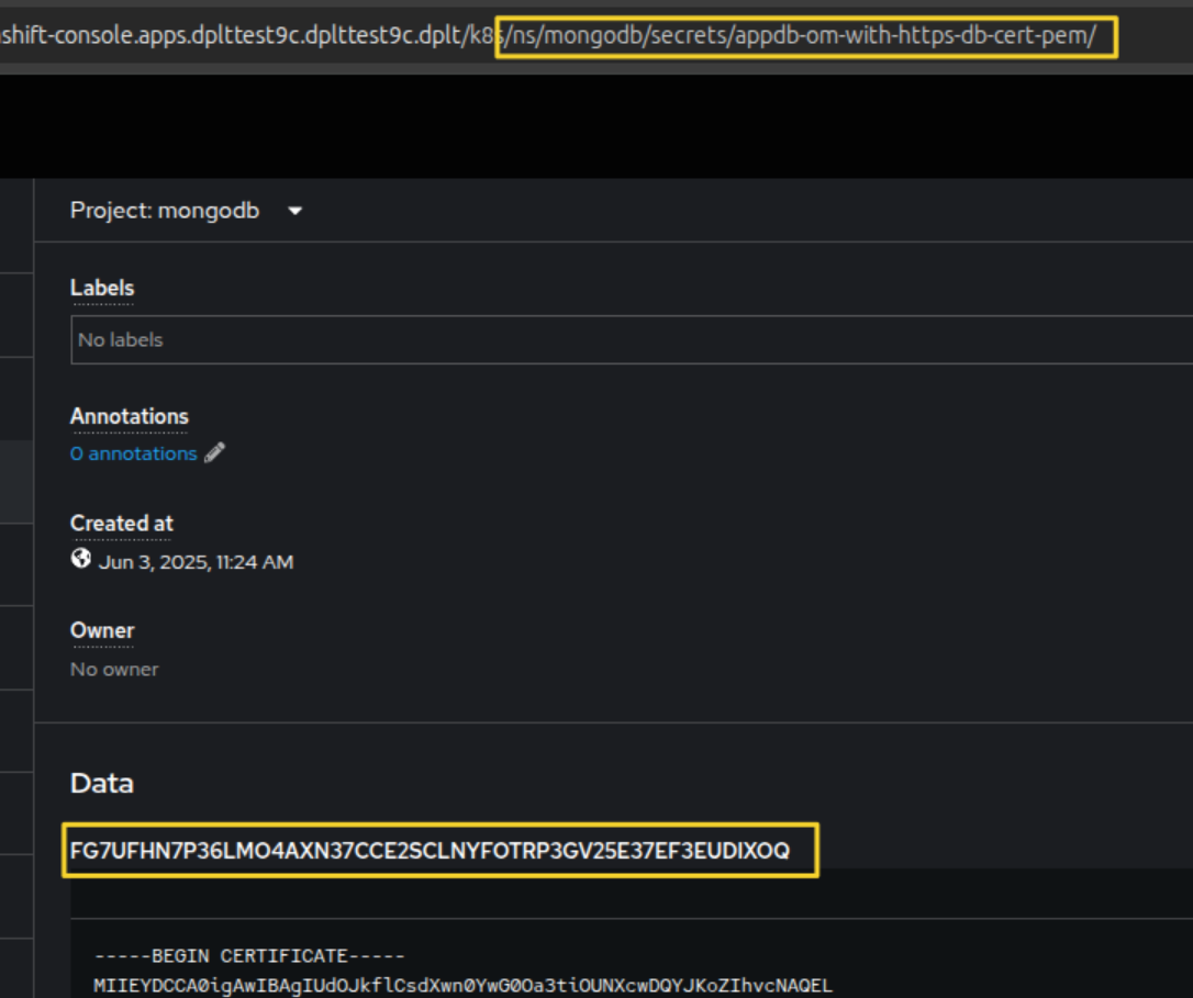

When a certificate (appdb-om-with-https-db-cert) is renewed mongo-enterprise-operator launch a renewal process to update 2 secrets (appdb-om-with-https-db-cert-pem and om-with-https-db-config) but the last part of the process fails.
Therefore, the cluster is left with an incorrect configuration within the om-with-https-db-config secret pointing to the old certificate (which no longer exists) instead of pointing to the newly recreated one.

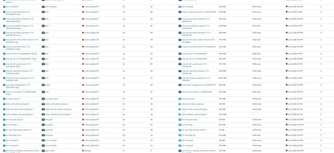

Due to this error after some time all mongo pods become to a CrashLoopBackOff state:

- Wait until a few renews after some or all pods in mongodb namespace are with CrashLoopBackOff state

Verify current certificate hash
Check config is pointig to wrong certificate
Modify config secret pointing to current certificate
